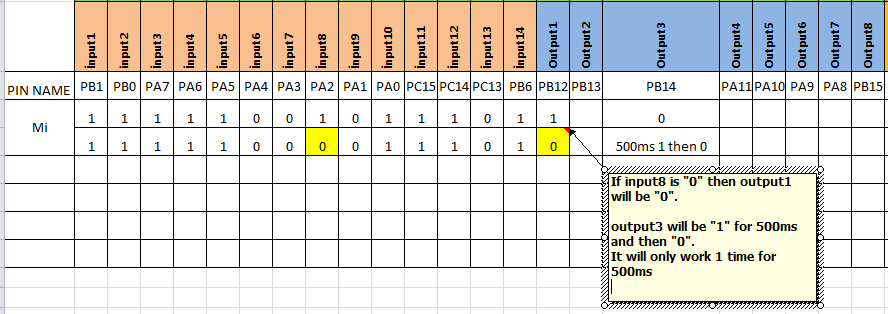

where I wrote it among the codes.. // Here I have to wait 500ms.
Can you help me to prevent the timers from being affected by this wait?
Can you give me the codes that I will add. Because I am very confused..
I tried many things but they all stopped the interrupts..

I don't understand what you mean, but I'm sure I can understand it more easily if you explain it only through my code. Could you please intervene in my code?
No, it does not reset. PinA10 always remains in the SET position.
This is perfectly normal when input1 == 1 time is ? You ignore reply to questions
All inputs are pull-up when they are idle..
If the input comes, they become "0"..
I ask time , you reply other... FYI Input1 10ms 0 and 500ms 1 after this 10ms 0
Result is your PA10 always SET. Or for detail is RESET for 10ms and set back.
But optimal is debug your code with breakpoints and check if code parts is realy executed.
volatile uint8_t input1 =1,input2 =1;
updated in ISR require volatile...

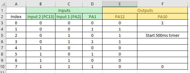

The code above is the code, there is no other code..
Remove TIM2 from your code is waste of timer with same base time. And change code

When Pin_A2 is "0", Pin A10 becomes "1".
Continuing..
If Pin_A2 becomes "1", Pin A10 becomes "0" after 500ms.
That is, it works in reverse.
There is no delay when the input comes
It waits for 500ms when the input disappears.
Note1 : I am writing with Translate, I hope I can explain.
Note2:
The program is currently running as follows.
When C13=1 and A2=1, A10=0
When C13=0 and A2 =0, A10 =1
500ms after C13=0 and A2 =1, A10 =0
It drops to 0 not when the input arrives, but after the input disappears.
Continuing..
Note2:
You need a truth table. So far from the code you've posted and your last post, I've made this table. There are some unknowns of what PA10 state is, so I left those blank.
You need to fill in the blanks so we really know what you're trying to accomplish with all the outputs based on all the input states.
