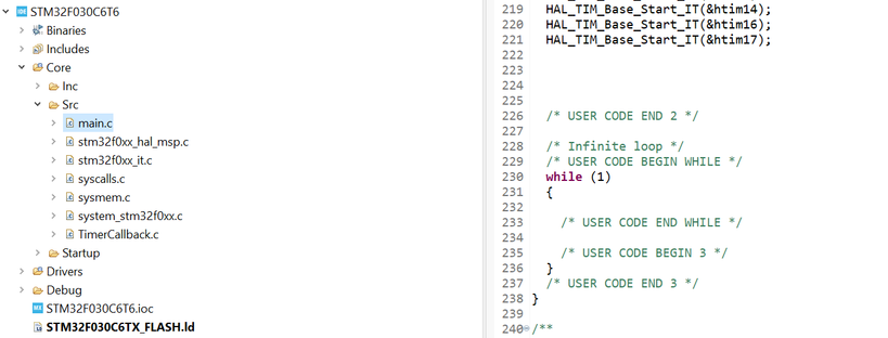

I guess I'm really ***. No matter what I do, it doesn't work.
TimerCallbackTimerStart(&timerCallback, PA10_Off, 500, TIMER_NO_REPEAT);
doesn't work..
PA10_off function doesn't work.

‎2024-11-17 7:34 AM - edited ‎2024-11-17 10:08 AM
I couldn't do it with TimerCallback either
It didn't work like this either..
If PA2 is 0, PB14 should be 1 and PB14 should be 0 again for 500ms.

Your project still looks the same. Your while loop is empty so not much is going to work.

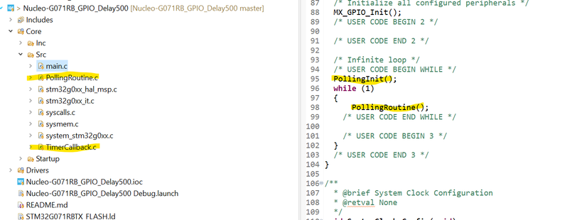

Your project tree should look like this

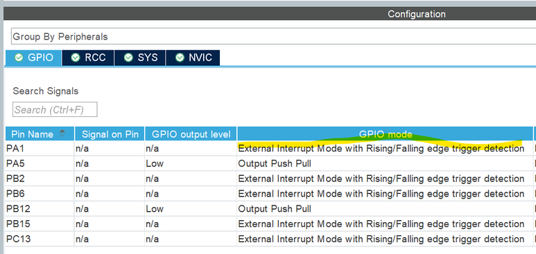

You don't have GPIO set up correctly for the ones that use EXTI. Only the pins that you are polling use Input mode.
I highlighted from my IOC what it should be like.
The TimerCallback.c/h and PollingRoutine.c/h just drop in your project. The only thing you need to do is change the GPIO names i've used to the name you used.
