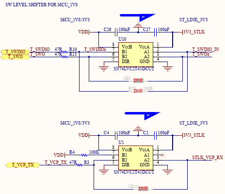

Dear all,
It seems like I actually broke two Nucleo 144 with a H7A3 and H723 after I tried to debug the MCU with the on board debugger and after switching the supply voltage for the MCU to 1.8V (no connection from debugger to MCU possible, even not with 3.3V again).
Is this problem known? If yes, I am wondering, why there is actually the possibility to switch to 1.8V. I found several blog entries that this is not allowed since no level shifters are on the board, but I couldn't find it in the user manuals of the mentioned boards. Did I miss anything?

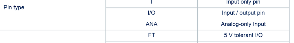

just from SWD connect 1,8 -> 3,3 V should be no problem, because pins 5V tolerant:
0693W00000WItObQAL.png0693W00000WItOlQAL.png0693W00000WItOvQAL.pngand from schema
https://www.st.com/resource/en/schematic_pack/mb1363-h7a3ziq-d01_schematic.pdf
nucleo144 has level shifters:
but NRST could be a problem... so should separate NRST pin. JP3 has to be open.

No problem encountered with Nucleo-H7A3ZI-Q with JP5 set to 1.8V, internal STLink and JP3 closed. Works like a charm. So your problem is most likely not directly related to the Nucleo boards but maybe to external circuit or power supply.
