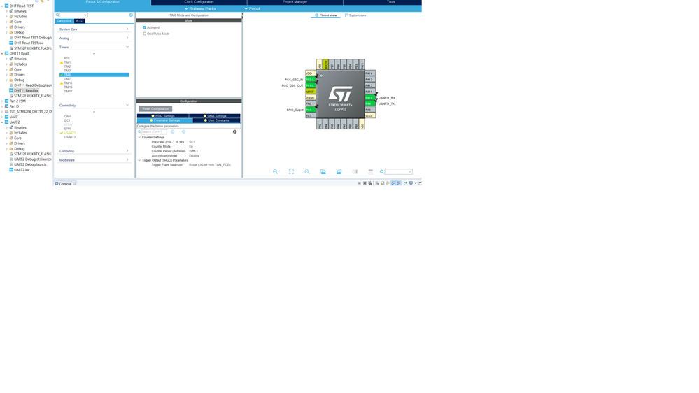

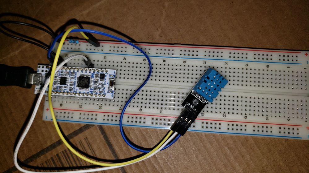

I am using UART to display the live readings of my DHT11 sensor similar to this blog post https://controllerstech.com/using-dht11-sensor-with-stm32/ and my program seems to stop around the DHT11_Read() or DHT11_Check_Response() functions. It seems to be some problem with reading the pin and getting a response that I'm not sure if the problem is timing or some problem with the physical device. It won't let me post 100% of the code but here is most of the non-auto generated stuff:
