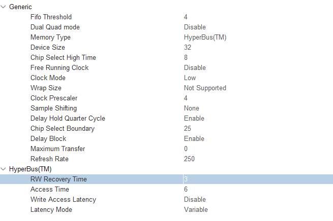

‎2023-04-03 4:26 PM
Thank you for answering me.
I am using the STM32H735 discovery, the problem is that the data I am reading is not the same written, it's like the data is totally corrupted. I have generated the code with STM32CUBEMX.
here is the configuration of the hyperbus memory:
‎2023-04-03 11:07 PM
I'm using the same board, works like a charm, memory-mapped mode.
Make sure that it's not running at more than 100 MHz.
Here's my almost non-HAL setup:

‎2023-04-05 5:56 AM
Hello @AAree.1​,
Unfortunately I can not specify the root cause of the issue, but I will try to provide general recommendations that might help :
- Please ensure that all the instructions of data cache are disabled and check if the problem persists.
- Please make sure you are respecting the timings of the memory's datasheet.
- Please check the configuration of the OCTOSPIM if used.
- Try working with low frequencies and check if the problem persists.
- When generating the code with STM32CubeMX please check the alternate functions generated.
Thank you.
Best regards,
Chahinez.
