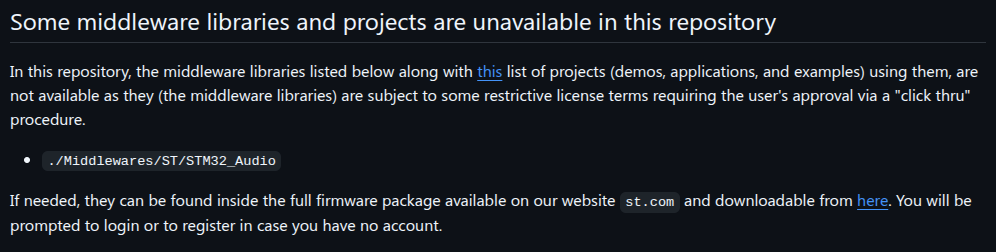

I was reading this conversation and found the comment about an example showing support of Audio Class with USBX and ThreadX
https://community.st.com/t5/stm32-mcus-embedded-software/has-anyone-managed-to-get-a-usbx-audio-device-working-on-stm32/m-p/112225/highlight/true#M5290
For some reason, the example is disappeared
Is there a reason on why it has been deleted? Is there a way to get it?
FBL
Hi @nico23
List of unavailable projects :./Projects/STM32H743I-EVAL/Applications/USBX/Ux_Device_Audio2.0_PlayBack
You can find it directly from ST.com.
The audio middleware stacks, such as STM32_Audio, STemWin, and TouchGFX, are not included on GitHub because they are subject to a restrictive license known as the ST Ultimate Liberty license. Before users can access these middleware stacks, they must agree to the terms of the associated license. Since this licensing process could not be implemented on GitHub, the solution adopted was to remove these middleware stacks from the package published on GitHub and keep them on st.com.

maybe this helping ...
So look at https://www.st.com/en/embedded-software/x-cube-azrtos-h7.html#get-software
