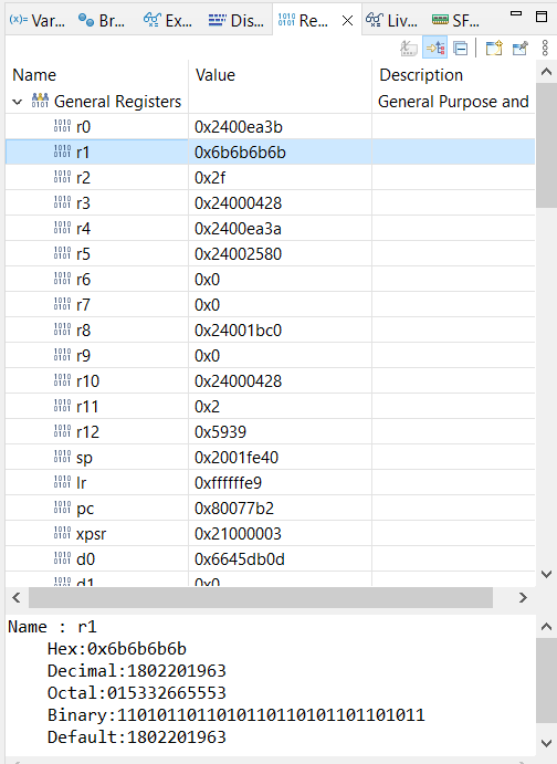

‎2024-05-16 2:36 AM
@waclawek.jan thanks!
I put breakpoint at start of hard fault handler, now I can check the registers when debugging.
What I see is what I saw earlier, when sometimes the saving of the registers in the hard fault handler worked:
CFSR:
BFARVALID and PRECISERR are set
BFAR and MMFAR hold the same value, this time it's 0x6B6B6B6B
This "address" seems to be a recurring pattern: it has always been this kind of four times alternating hex numbers (like 0x1D1D1D1D, or 0x23232323, or as above the 0x6B6B6B6B)
Does this make sense to anyone?
I thought with BFARVALID the address in BFAR would make sense
But where can I find what actually triggered the hard fault if the BFAR content does not make sense?
‎2024-05-16 2:46 AM
Addition to the post above:
I find the BFAR value 0x6B6B6B6B also on the CPU register R1:
‎2024-05-16 3:07 AM

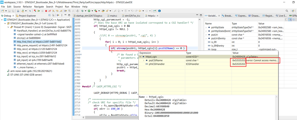

Checking list / map files, some of the registers contain addresses pointing to some lwIP / http / SSI / CGI functions.
This could actually make some sense, because the client (PC browser) gets a self-refreshing html page to display update progress.
Getting closer...
‎2024-05-16 4:35 AM
As I've said, you have to look at the stack for the PC before the fault handler is called (actual content of PC points to the fault handler). Then look at the code where this reconstructed PC points, in particular look before that point (in case of precise error it should be the previous instruction, in case of imprecise error it may be a couple of instructions before that. You will probably see some access - load/store - to the offending address (i.e. here through [r1]. To find out what and why is that access, you have to read a bit the asm, together with sources - that's why mixed source/asm is the best way to look at these things.
IDEs may help to decipher this for you, i.e. show the reconstructed registers, point to the source where the reconstructed PC points, show stack backtrace - I don't use IDE.
‎2024-05-16 8:29 AM
I hope and think I got it:
lwIP's httpd calls http_parse_request() calls http_find_file() which also checks the URI for CGI commands.
CGI application info is stored in a table containing 2 pointers for each entry, one to a constant string (like "/fileup.cgi") and the other to the respective function (called something like CGI_Handler_FileUp()).
These are constants stored in flash.
I check the contents and addresses of these at http server init and get these results, which make sense:
CGI HttpServerInit():
CgiTable[0].pszCGIName = /fileup.cgi @ 080239BC
CgiTable[1].pszCGIName = /admin.cgi @ 080239B1
When not working with the internal flash, these pointers seem to work well.
But when there's flash writing going on, these constants cannot be accessed, and somehow some weird value is assigned, see picture below.
And these are the values found in BFAR and MMAR (0x53535353).
‎2024-05-16 8:48 AM - edited ‎2024-05-16 9:03 AM

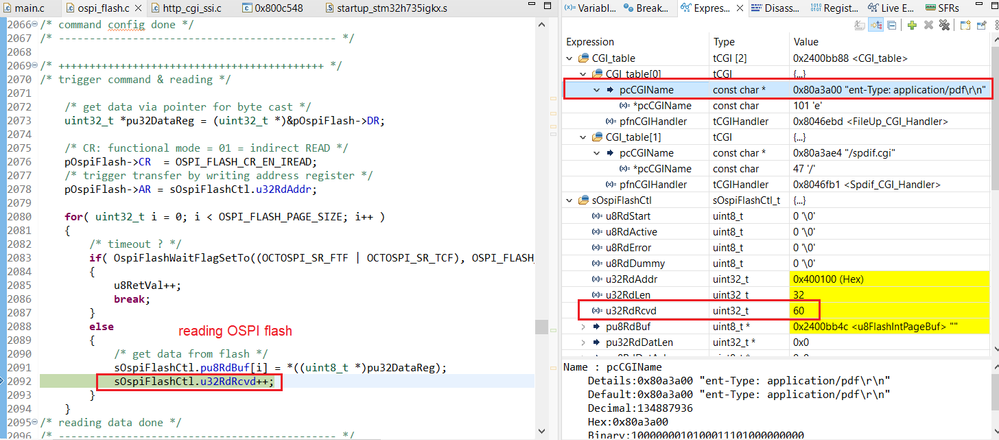

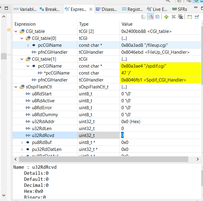

All of a sudden the compiler moved the variable CGI table to the start of AXI SRAM D1 - no more problems.
No matter what I tried, the compiler didn't move it anywhere else in further compilations.
But I still have the "application", which showed the same behavior when updating the bootloader.
And yes, the current app does the same:
It looks like the variable holding the CGI table pointers above gets reset while reading from OSPI flash, when the "bytes received counter" is incremented.
It looks like the pointer is moved to somewhere else, in this case to one of the http constants for pdfs...
Now I'd like to understand: how can this happen?
Picture 1: CGI table as it should be
Picture 2: CGI table changed by OSPI flash reading
