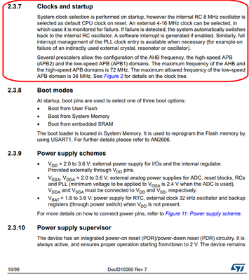

The datasheet will tell you what the default clock configuration is at startup; eg,

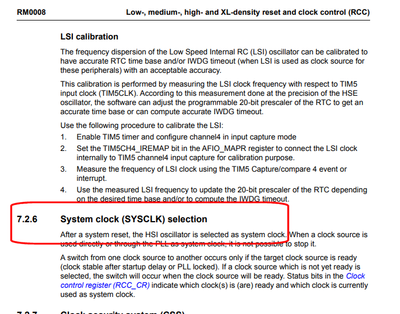

See also the Reference Manual:
So, of course, you can work it from there.
