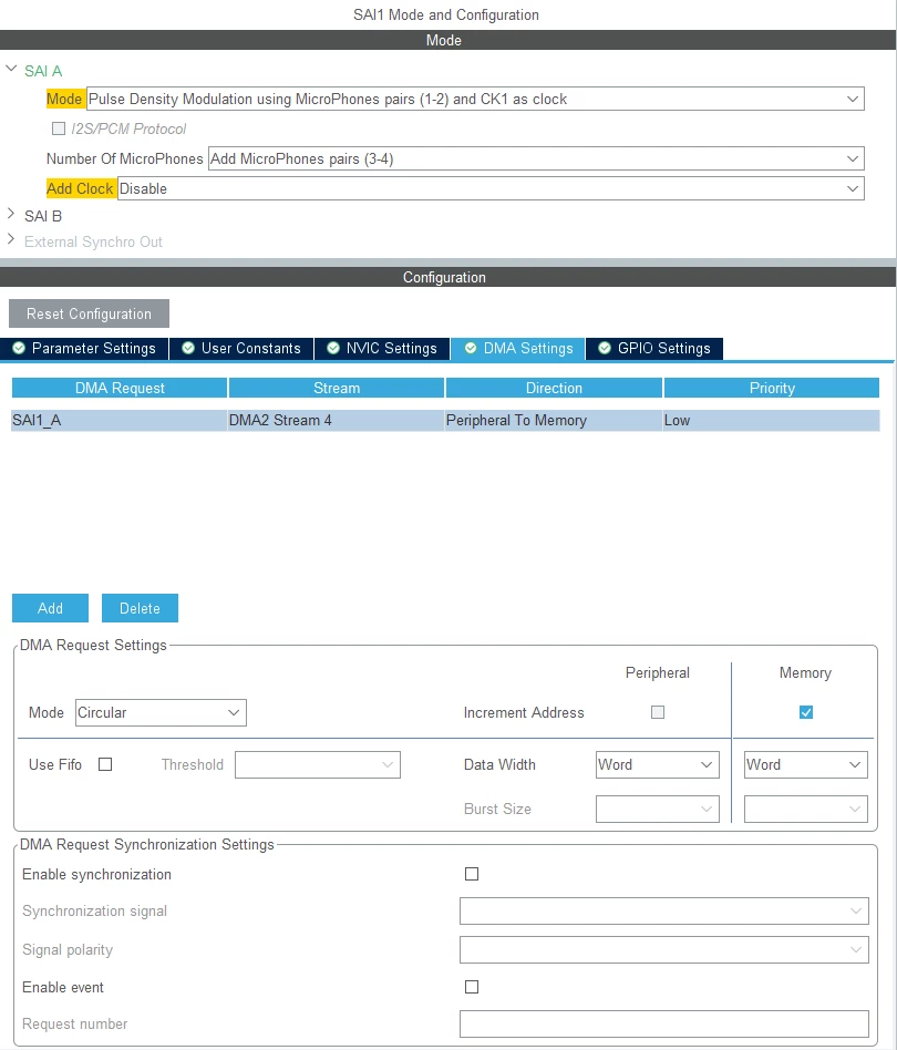

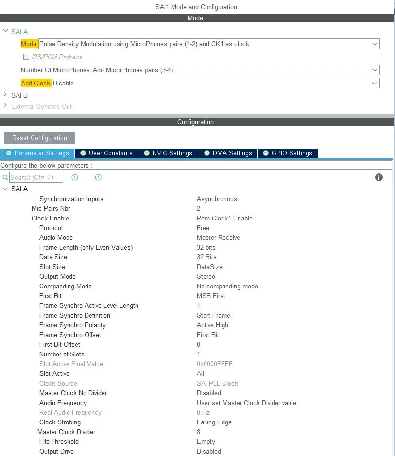

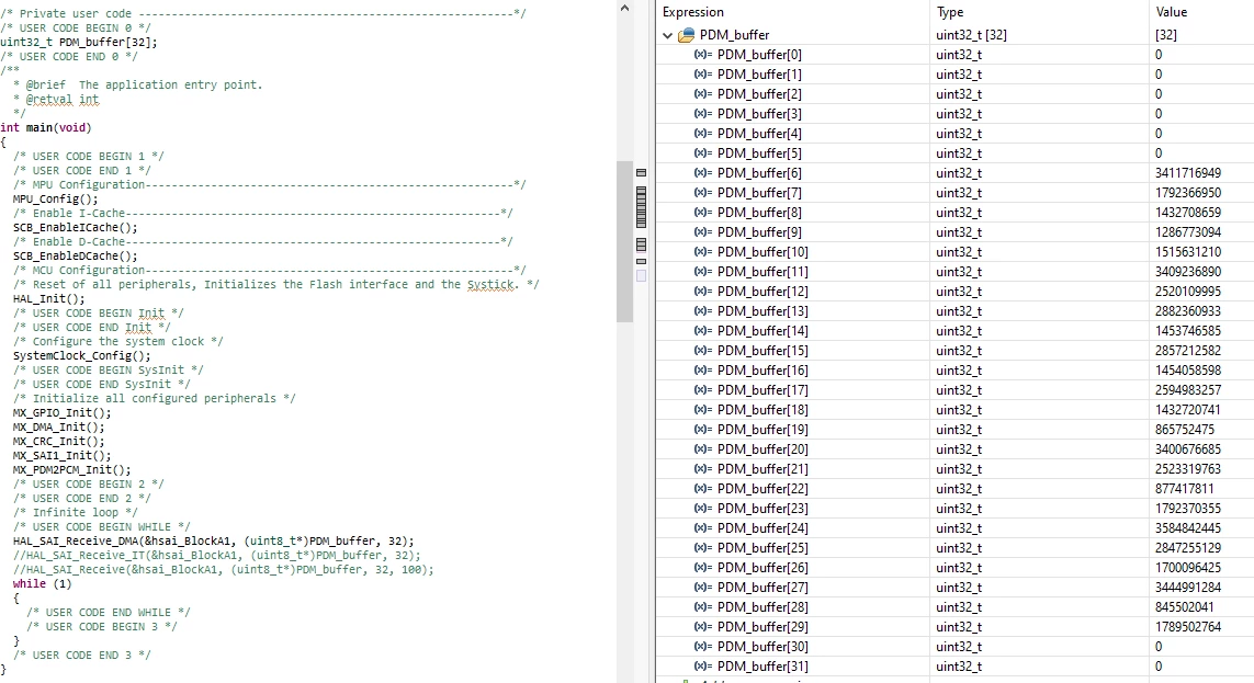

I have configured the readout of 4 PDM microphones through the SAI interface. I am using 1 slot of 32 bits per frame.
I have enabled DMA.
0693W00000aHesVQAS.pngUnfortunately, when reading PDM data, the first 6 and last 2 values of the array are filled with zeros. This happens regardless of the size of the PDM_buffer.
Do I have something misconfigured? What could be the cause?
Edit: If the PDM_buffer array is of type uint16_t, there are 2x more zeros (12+4 ), and in the case of uint8_t 4x more zeros (24+8).

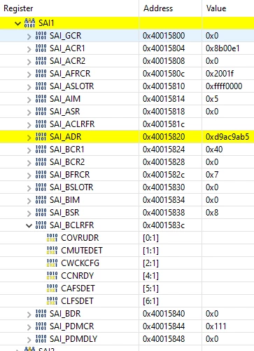

waclawek.jan
February 25, 2023
Which STM32?
Read out and check/post content of DMA and SAI registers, perhaps at the point just before SAI gets enabled.
If DMA is circular, I see no reason why DMA buffer won't get filled entirely.
[EDIT] Although you did not tell us the STM32 model you are using, you enable caches in code, so mind cache coherency and DMA - read the related note here.

AScha.3
February 26, 2023
>How can I read out content of DMA and SAI registers?
in debug (when paused) -> SFRs
can see all peri. registers

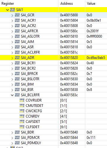

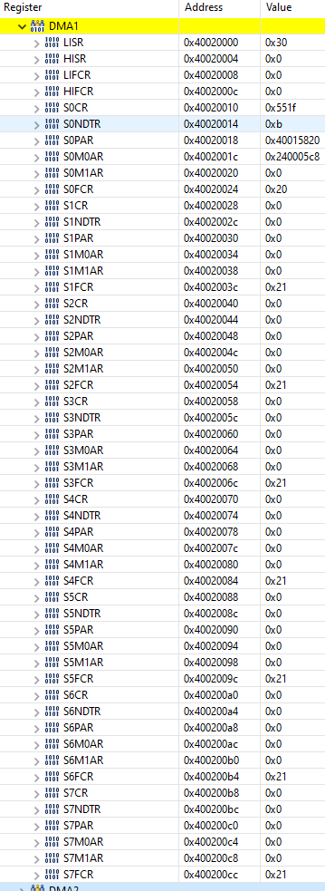

RPuch.2
RPuch.2Author
February 26, 2023
SAI and DMA registers:0693W00000aHfnbQAC.png0693W00000aHfnWQAS.png
RPuch.2
RPuch.2Author
February 26, 2023
To see proper register values, I had to pause and resume debug process.
S0NDTR and SAI_ADR change after every pause.
Edit:
None of the 3 solutions from the link worked.
After commenting out the SCB_EnableDCache() line, it populates the array correctly for me.
