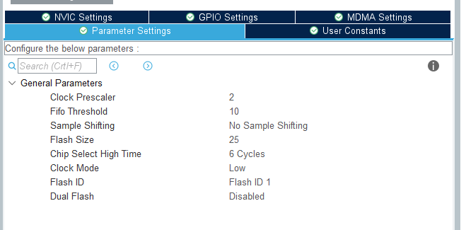

I am trying to create an external loader for my project by ST's "How to create an external QSPI loader MOOC" lesson. Actually lesson's github repository have microcontroller and quad spi flash configurations that I use. I just change some pin configurations for my board's need.
Although I do everything like lesson but my external loader doesn't work correctly. It load flash shifting a byte. For example if my first 4 byte is {11 22 33 44}, external loader is loading these bytes flash like this {22 33 44 xx}. My all data is becoming can't usable because of this problem.

‎2021-02-22 12:05 PM
Actually lessons code have a test harness. I implemented this section to my project like this;

When I debug code with this, code stopped to last "while". My quad spi configuration like this;

‎2021-02-22 1:40 PM
I use STM32H743XI microcontroller and MT25QL512 quad spi nor flash. I am using exact same Loader files and quad spi drivers in this repository. Maybe these would be revealing
