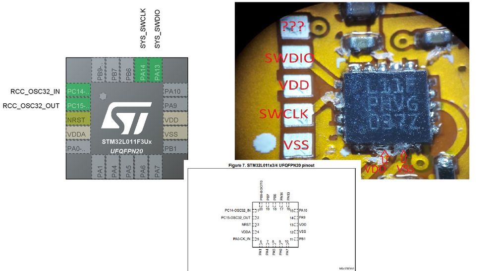

I don't know what to do, the chip in the picture has jumper inputs and I tried to connect with stlinkv2 using them. But it didn't happen. Also, there is a 5th jumper input that I do not know. What is it?
Tesla DeLorean
Guru
February 21, 2021
What board is this? Do you have schematics?
Could you probe the circuit for continuity? Perhaps it's NRST?
Is the chip powered?
Pin 1&2 of the ST-LINK/V2 don't supply power, but need to see the voltage the Target device is using.
For examples, perhaps try review those in CubeL0
STM32Cube_FW_L0_V1.11.0\Projects\NUCLEO-L011K4\Examples\GPIO\GPIO_IOToggle
