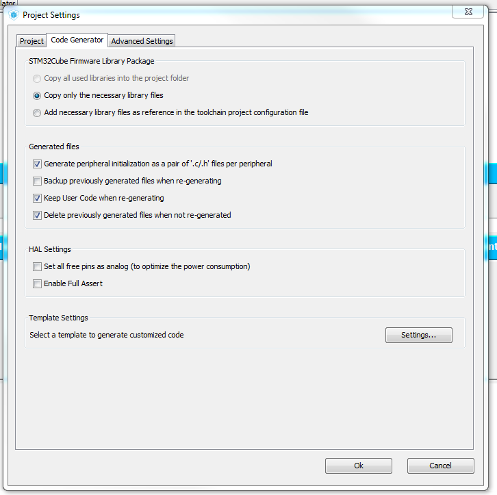

I can have Cube backup the files its going to overwrite.
It can recognized my code sections within a generated file, update the whole file and leave my code in new file.
It can figure out that i have removed a peripheral and delete the old files.
Is really too much to ask it not overwrite a file i mark as readonly in the OS after i add a workaround outside of user code sections?
Simple checkbox, check file protection before overwrite, if its READONLY leave it alone.

I found a problem in 'HAL_RCC_ClockConfig' function from 'STM32Cube_FW_F1_V1.6.0' firmware library
which I have to correct every time I generate code in CubeMX. It was so annoying. So, as a workaround I corrected  function definition in firmware library itself as it is used by CubeMX to generate code. Now everytime CubeMX generates code with my changes in it. You should patch your changes in CubeMX firmware library itself. The location of firmware library can be found in CubeMX project settings.

Using a version control system is sound advice. You check in/commit the originally-generated files, then with your changes/patches (use comments to mark them so that they are easy to find) and now when you regenerating the code you immediately see all changes and can accept (not your modified code) or reject (your modified code) them. Either by-file or line-by-line.
Granted, it still is always manual work, but that way you also don't miss actual improvements and bug-fixes in the code generator itself which is what you would do if you declared whole files as 'never touch again'.
