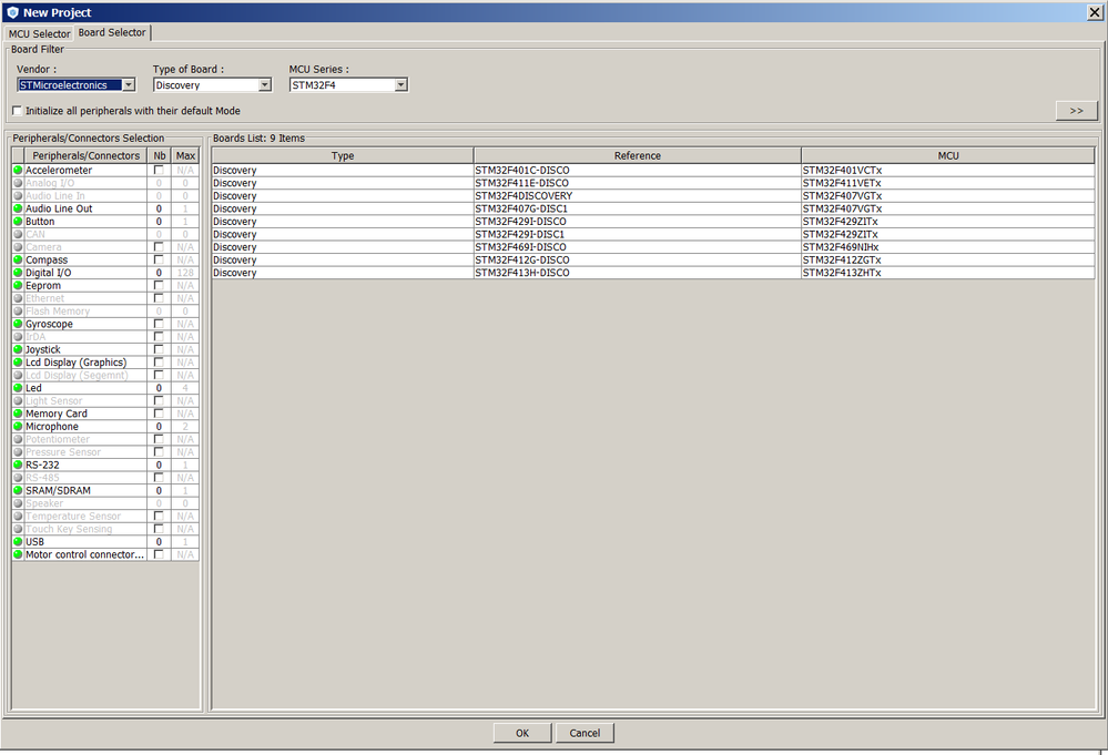

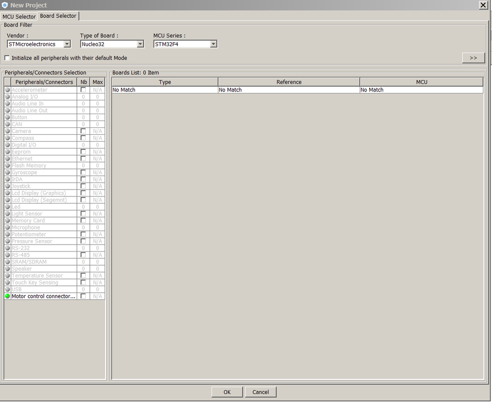

My target: STM32 Nucleo-F401RE board that I am using to learn the STM series processors and libs, programming strategies. However, there is no board selection for any 'Nucleo F4' boards in the v4.19 CubeMX, yet there are board selections available for STM 32F4 'Discovery' boards as can be seen in the two screen captures below.
CubeMX v4.19 Missing Nucleo-F4 Board Selection Problem
CubeMX v4.19 32F4 'Discovery' Board Selections are available

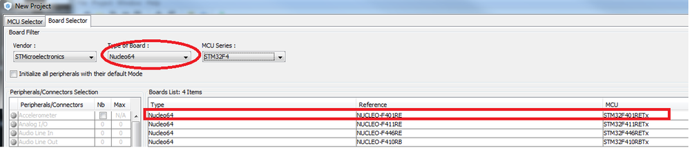

    The STM32F401RE device contains 64 pins. So, in CubeMX, you should choose ''Nucleo64'' and not ''Nucleo32''.
    Just for you information, there is also another Nucleo64 pin (other than the ones that you have already enumerated); which is the Nucleo-F446RE.

    Thanks for the nice and cogent reply. Hah! Actually I came back to the forum as it dawned on me that the 'Board' selector 'type' indicates the number of uController package pins. Clever. Probably would have figured it out if I had expended just a bit more time click'n & clack'n on CubeMX and doing a bit more reading of the UM1718 manual.
