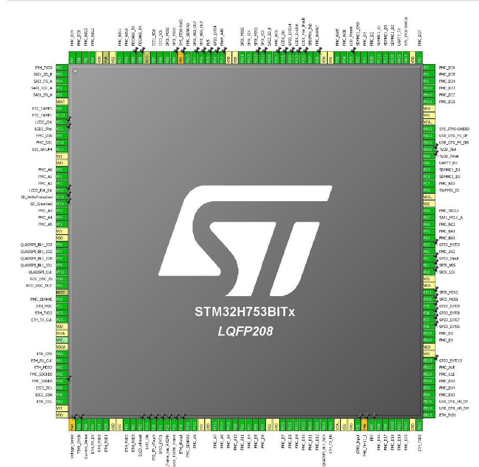

its a question of complexity.
the complexity is squared for the chip size.
ie, LQFP 32 STM32F103, its an easy enough job by hand,
but when you have 176-240 pin STM32F7 I would guess it is extremely difficult by hand,
but don't forget the PCB.
I would say, from scratch, its very unlikely that you would be able to design a high density working board without the cube.

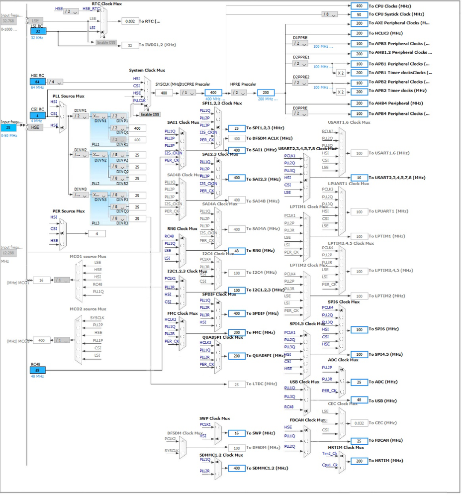

I use the cube to make my PCBs and then the initialisation code comes up and we get to while(1);
did you see the range of clock options inside the H7 part ?
very difficult to set the clock configuration without the cube.
