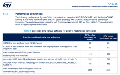

Hello @Sushmita
The AN5325 " How to use the CORDIC to perform mathematical functions on STM32 MCUs - Application note " describes some requirements of CORDIC and performance evaluation (section 3) of mathematical expressions (cos and sin) compared to an equivalent function from a software library such as math.h.
An example is provided in the STM32CubeG4 MCU Package, under \Projects\NUCLEO-G474RE\Examples_LL\CORDIC\CORDIC_CosSin. This example performs a polar to rectangular conversion using the cosine function.
For cos and sin, there is an enhancement of a factor from 5 to 10 can be reached in terms of speed when using CORDIC accelerator versus math.h and arm_math.h software.
Please try the provided example of evaluation in the AN5325. If you are still not convinced with materials and results inside, we need your software implementation of cos/sin to compare it versus CORDIC.

Hi @Sushmita
The HAL_CORDIC_CalculateZO() API you are calling by cordic_q31_cosf(float x) is counting all config, data formatting ... Not only the CORDIC computation process.
For rational performance estimation, in pooling mode, I point you to the following code example in ~\STM32Cube_FW_G4_V1.5.1\Projects\NUCLEO-G431RB\Examples_LL\CORDIC.
This code is based on the STM32 low level drive (LL).
The code is also described in section 3.1 of AN5325 "Acceleration example".
Step 1 is done only one time.
Step2 and 3 can be measured using (DWT or systick as follow):
/* Read systick counter */
start_ticks = SysTick->VAL;
/* Write angle */
LL_CORDIC_WriteData(CORDIC, ANGLE_CORDIC);
/* Read cosine */
cosOutput = (int32_t)LL_CORDIC_ReadData(CORDIC);
/* Read sine */
sinOutput = (int32_t)LL_CORDIC_ReadData(CORDIC);
stop_ticks = SysTick->VAL;
/* Calculate number of cycles elapsed */
elapsed_ticks = start_ticks-stop_ticks;
In your bedchmark, I suggest you integrate the lines 4, 6 and 8 above.
