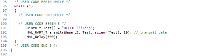

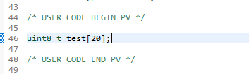

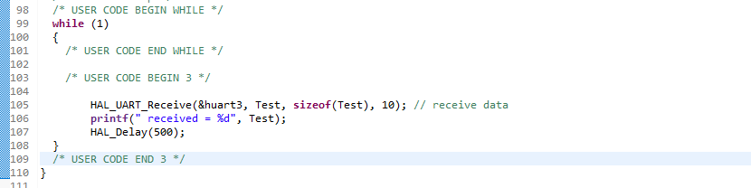

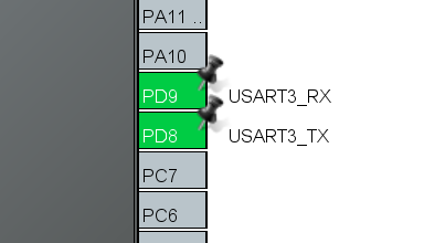

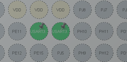

Hi, may I know how to connect two stm32 board using uart?
Im using nucleo g071rb to transmit the data to STM32H750-DK. So basically i just want to try simple application using serial but it not successful.
so what i want to do Nucleo G071 transmit data to STM32H750 use simple application like g071 will send word HELLO to stm32h750-dk.
nucleo G071 - transmit
STM32H750 - received
this pin configuration and code for g071
this one is pin configuration and code for stm32h750-dk
So i have done wrong? and please someone help me.

KnarfB
February 10, 2023
RX and TX must be crossed.
Receive must be "always on", so don't HAL_Delay, you may miss char's.
The blocking Receive you are using waits until the buffer is full or timeout, you might want to read single char by single char.
There are more perfomant but complex methods like reading by DMA, see https://github.com/MaJerle/stm32-usart-uart-dma-rx-tx
hth

Hello @Angle​ ,
Please check:
-The connection between two boards:
  • Board 1 RX connected to board 2 TX
  • Board 1 TX connected to board 2 RX
  • Board 1 GND connected to board 2 GND
-Try to verify if the  Nucleo-G071rb can be able to transmit data.
May be this example help you UART_TwoBoards_ComPolling.
I hope this help you.
