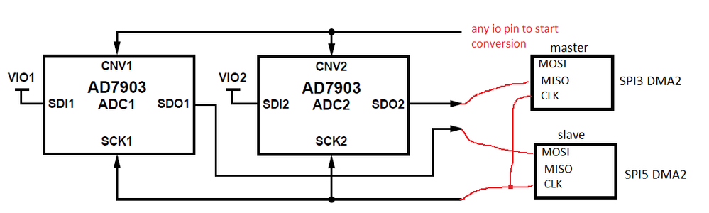

I want to connect an AD converter AD7903 with the STM32F429
http://www.analog.com/static/imported-files/data_sheets/AD7903.pdf
The AD7903 can be driven in a simultaneous sampling mode. It is show in the datasheet on page 25.
1.
Im not sure, if I have connect the AD7903 in the right way. I want to connect it, like in the picture.
Is that ok, or must I split the clk conduct in CLK from SPI1 and CLK from SPI2?
But then I have the problem, that is not be simultaneous.
2.
I dont use the MOSI pins. Can I use them as a normaly pin, if I not activate the alternative function of this pin.
3.
The maximum datarate of the AD7903 is 1MSPS. Is the STM32F429 with SPI fast enough?
I have estimate if f_PCLK = 84MHz and I use a divider of 2, than I get a clock frequency of 42MHz. If I transmit 16Bit I get
42MHz/16 = 2,625 MSPS. Is that ok?
4. Is it possible to get samples of the STM32F429ZIT6 ? I have try it, but I get the answer, that I can buy it by xyv distributor.
Thank you very much, for your help in advance
Best regards
Dirk

If you want them to work synchronously, then perhaps you can daisy-chain them and shift the data out as two 16-bit words?

Use one SPI as master and the other as slave, feeding the clock from the master to slave.
Yes.
> 42MHz. If I transmit 16Bit I get 42MHz/16 = 2,625 MSPS. Is that ok?
I did not read the datasheet of AD7903, but if the sample/conversion time overlaps the shift out, then yes. However, count on the inflexibility of the SPI clock scheme - you have no other choice than fPCLK/2^N (N=1..8). Also, not all SPI are on the faster APB2 bus.
Also, you will need to process the read data, and you have only some 160 cycles per the couple of samples  - whether that is sufficient depends on your particular application.

I have connected the AD7903 with the STM32F4 in the following way:
I want to use a clock speed of 21MHz, because the SPI interface in slave mode has a maximum clock speed of 21MHz. Otherwise I would choose 42MHz.
I want to continuously save the data from the AD converter with a clock frequency of 21MHz. I use the DMA2 controller, but I dont know, if this is fast enough to save the data in memory.
1. Can I get problems with the clock speed of 21MHz?
2. Assuming, I would use a clock speed of 42MHz. The same question like under point 1, can I get problems to save the data fast enough?
3. Is it better to split them into DMA controller 1 and DMA controller 2 ?
4. If I use SPI3 and SPI5 both in master mode and ADC1 is to SPI3 and ADC2 is connected to SPI5. Then I have two separate clock wires. Is the clock frequency synchronuos? No, or?
Thank you in advance.
Best regards,
Dirk

You'll have to own your development and experimentation tasks. Your going to have to do these thing to know what is/is not viable for your application.
Yes, suspect 21 MHz would be fine. Short wiring, appropriate grounding and signal paths.
DMA, don't see that being an issue the data rate is 1/8 or 1/16 of the bit clocking rate, so bandwidth to memory should be adequate. Transfer enough data so you won't saturate interrupts. ie have a packet length of 100 bytes, use HT/TC DMA interrupts to manage a circular ping/pong operation.
Two masters, yes the signals will be synchronous, but probably not in-phase with each other. The master/slave configuration looks to have the best potential, though you'll need to pump the master TX DMA, no experience here with Rx only configuration in that regard.
