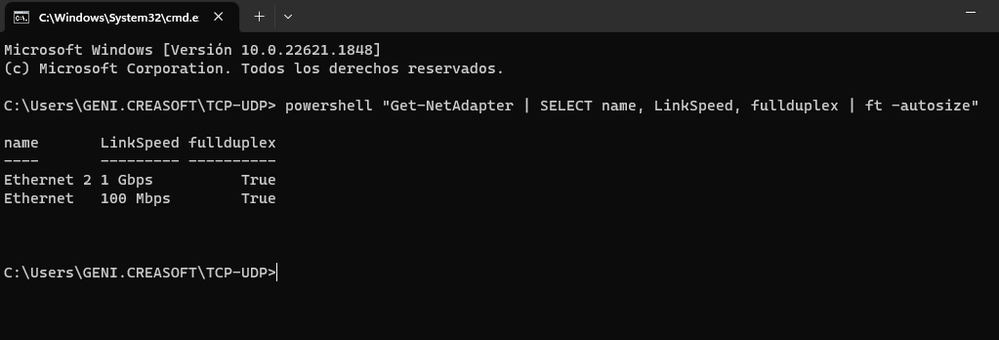

Sometimes when server is running link is detected as down. So we were debugging and checking MAC registers where PHY is putting their register values using the mdio interface (for status and control communications).
Observations:
1.- Autonegotiation result and MAC configuration:
When link up is detected and autonegotiation occurres it seems that PHY is detecting that mode is half-duplex, despite ethernet_init is forcing full-duplex mode. But register has on this bit the value of a half-duplex autonegotiation result. So, here we thought that -for some reason- LAN was only able to talk with the remote host by this mode. Despite this, system communications seems very quick. So we want to be sure and we asked Windows 11 for speed and mode ethernet cards connections. This was the answer:
  • Does this mean that LAN device is wrongly detecting "half-duplex" and LAN is configuring MAC driver for working in half duplex because of LAN register wrong value but ethernet communication between 2 hosts are actually full-duplex?
2.- Linkdown detection and loopback mode

About the half-duplex problem:
If you are using ETH HAL, maybe there is still the bug that HAL ethernet init is reading the wrong register from the LAN8742 to evaluate the negotiated settings. That was the case for me with an F7.
And if one side is setup wrong (PHY and host are working full duplex, but STM's MAC thinks it's half-duplex) strange things start to happen...

genisuvi
 Thanks @LCE , I'm worried about this situation. MAC is completely wrong and it is thinking it's in half duplex when not. Even DMA ethernet descriptor status "duplex-mode field" says that it is half-duplex. ST is a great company and has devices used in a lot of electronics industry products. It's a big big fail! big and basic issue: to know which speed and duplex mode the link has!
You are right, the PHY_REG_SR is 10 and should be 1F on my config.h HAL file.
