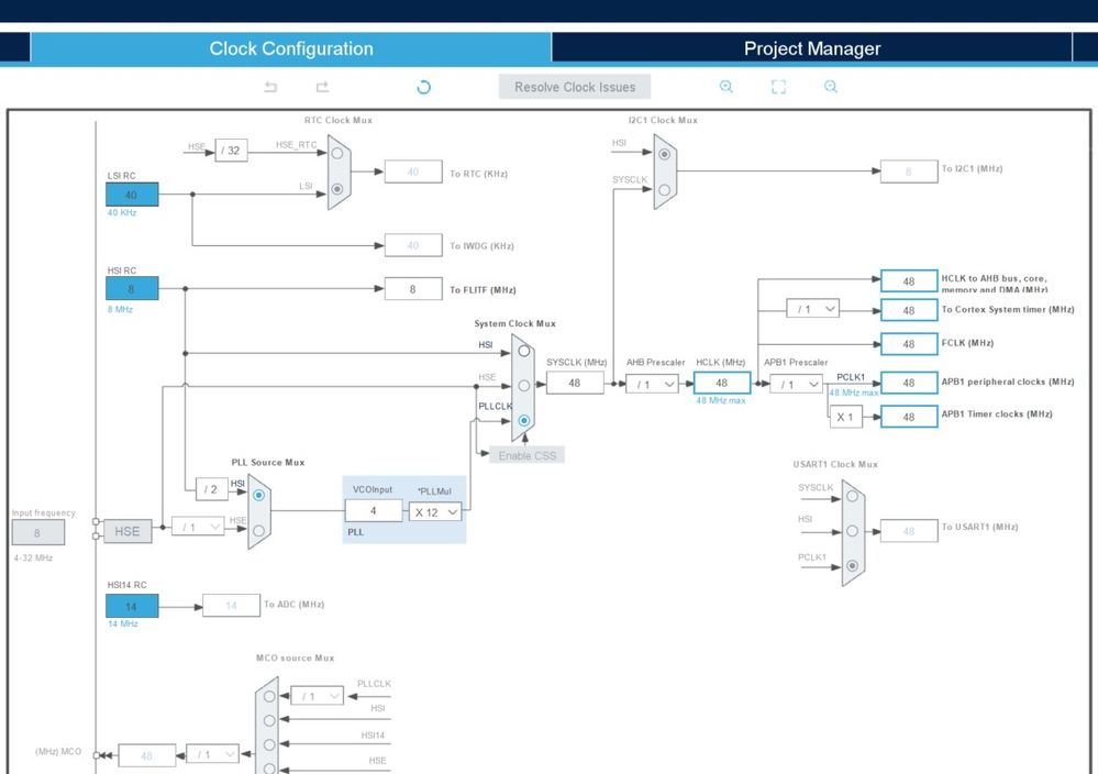

configure system clock using registers for stm32f030k6t6
jdo
0693W00000QNZsmQAH.jpgI need to configure the system clock using registers for 48mhz without external crystal, I already have it configured and tested with stmcube ide manager, but I need to decrease the flash memory and ram, as they are critical.
i have this configuration step for 32mhz, but with external crystal:
/* 32MHz HSI PLL Configuration */
		RCC->CR &= ~RCC_CR_PLLON; /* Keep PLL off */
		RCC->CFGR &= ~RCC_CFGR_PLLSRC_Msk;
		RCC->CFGR |= RCC_CFGR_PLLSRC_HSI_DIV2;
		RCC->CFGR &= ~RCC_CFGR_PLLMUL_Msk;
		RCC->CFGR |= RCC_CFGR_PLLMUL8;
		RCC->CR |= RCC_CR_PLLON; /* Turn PLL on */
		while ((RCC->CR & RCC_CR_PLLRDY) == 0); /* Wait for PLL to be ready */
		RCC->CFGR &= ~RCC_CFGR_HPRE_Msk; /* Clear AHB resister */
		RCC->CFGR |= RCC_CFGR_HPRE_DIV1; /* AHB Prescaler */
		RCC->CFGR &= ~RCC_CFGR_PPRE_Msk; /* Clear APB1 resister */
		RCC->CFGR |= RCC_CFGR_PPRE_DIV1; /* APB1 Prescaler */
		RCC->CFGR &= ~RCC_CFGR_SW_Msk; /* Clear SW resister */
		RCC->CFGR |= RCC_CFGR_SW_PLL; /* Set PLL as system clock */
find in the internet the step for configure clock is:
1._ ENABLE HSI and wait for the HSI to become Ready
2._ Set the POWER ENABLE CLOCK and VOLTAGE REGULATOR
3._Configure the FLASH PREFETCH and the LATENCY Related Settings
4._Configure the PRESCALARS HCLK, PCLK1
5._Configure the MAIN PLL
6._ Enable the PLL and wait for it to become ready
7._Select the Clock Source and wait for it to be set
THE STEP ONE I DON´T KNOW THIS IS RIGTH.

gbm
Principal
  1. Don't enable HSI - it's already enabled after reset.
  2. Set the PLL parameters in RCC->CFGR
  3. enable PLL in RCC->CR
  4. wait for PLL stabiized
  5. set Flash wait states
  6. Switch to PLL clock
This makes 5 lines of code total

jdo
i am using the SystemInit() generated for excel macro

the main code is:
i want view led blink in PA12, but i don´t view blink, the led is fixed on.
