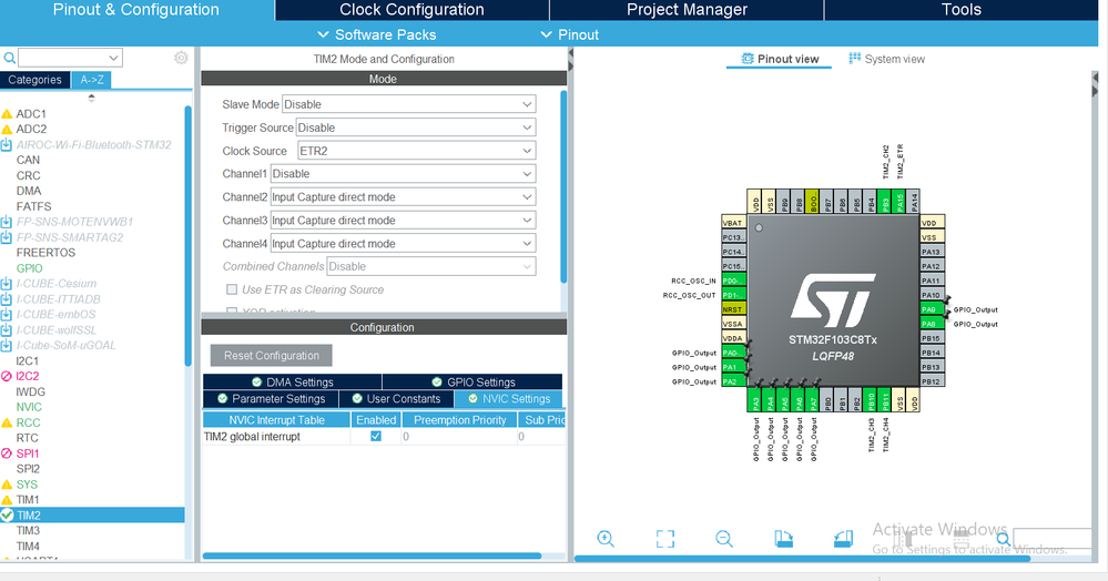

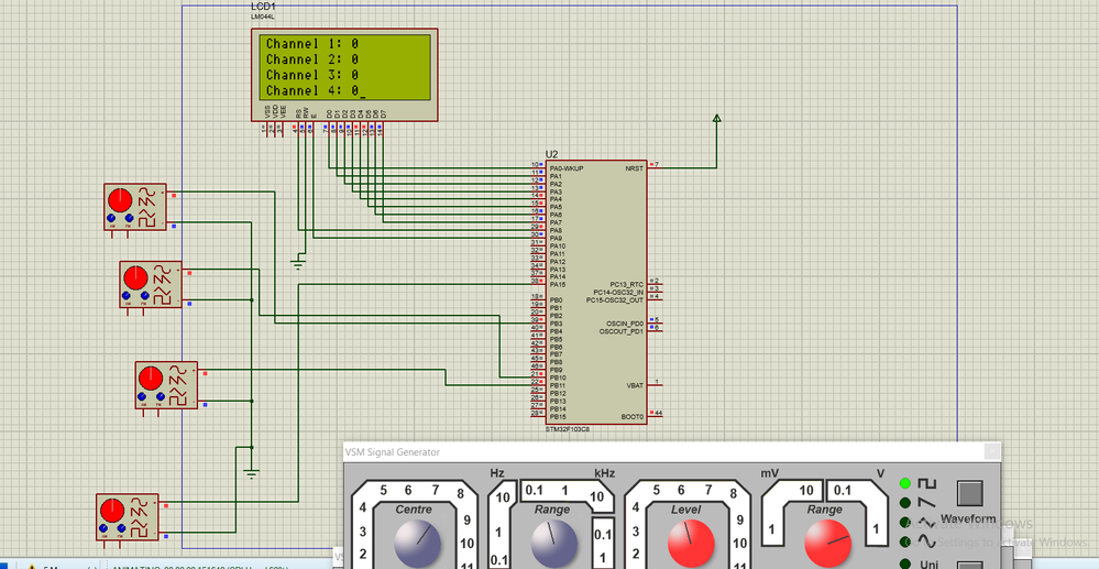

i was trying for sometime now to configure stm32 timer as a counter to count the pulses in order to count the RPM of a rolling gear and then show it on a lcd screen, and no matter what i do or change in the code or the timer configuration, the number of pulses is always stuck at 0. can anyone please help me with it? i really need it for my studies. (by the way, i am using a proteus simulation to test it).

AScha.3
how you get the pulses to the counter ?
You need select the ETRx as input to count external pulses.
Or TIMxx input capture, to measure just one pulse-pulse timing and calculate speed then.
@AScha.3 i already tried that...
Hello @medraouf ,
As stated by @AScha.3 ETR is a serious candidate for your use case.
No one here can imagine what you did ..
You need to share your code to let community members to help you efficiently + your HW connections.
It could be an issue with your IO configuration or even with the timer itself ..

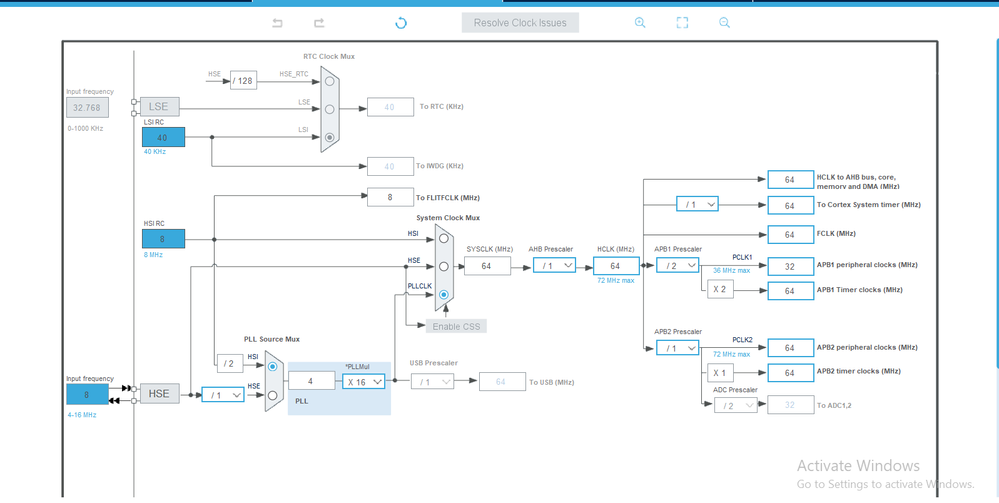

    // Set TIM2 prescaler for 1 us resolution (assuming HCLK = 64MHz)
    TIM2->PSC = 64 - 1;

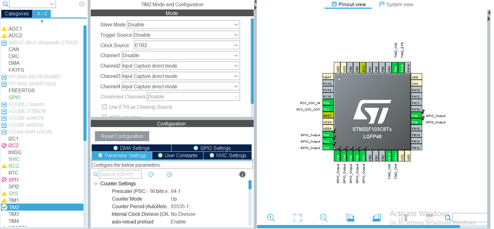

    // Configure TIM2 channels as input capture
    TIM2->CCMR1 |= (TIM_CCMR1_CC1S_0 | TIM_CCMR1_CC2S_0);
    TIM2->CCMR2 |= (TIM_CCMR2_CC3S_0 | TIM_CCMR2_CC4S_0);
    // Enable capture on both rising and falling edges
    TIM2->CCER |= (TIM_CCER_CC1P | TIM_CCER_CC1NP | TIM_CCER_CC2P | TIM_CCER_CC2NP |
                   TIM_CCER_CC3P | TIM_CCER_CC3NP); // Remove TIM_CCER_CC4P | TIM_CCER_CC4NP
    // Enable interrupts on capture events
    TIM2->DIER |= (TIM_DIER_CC1IE | TIM_DIER_CC2IE | TIM_DIER_CC3IE | TIM_DIER_CC4IE);
    // Enable TIM2 interrupts
    NVIC_EnableIRQ(TIM2_IRQn);
    // Enable TIM2
    TIM2->CR1 |= TIM_CR1_CEN;

as you can see, the pulse number is stuck at 0 although i'm giving it a pulse signal from the the pulse generator. (note: i tried the same thing but without using the timer, only the interrupts of the stm32 and it worked, but there was a difference between the 4 channels, i guess because of the high frequency of the pulses, that's why i'm using the timer.)
