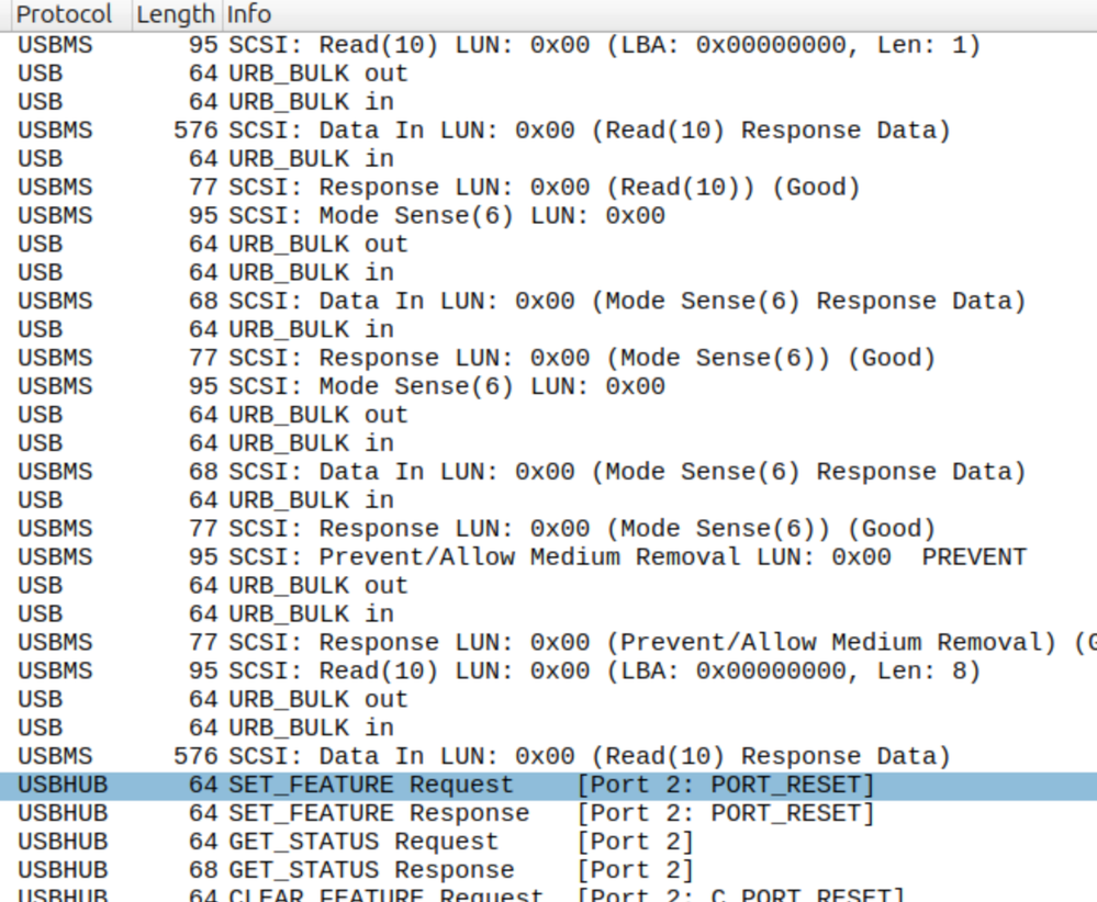

I'm working on a firmware which currently run in USB vendor interface (bInterfaceClass = 0xFF) and it's working.
Now I want to add MassStorage. My Firmware is a bit older so I add all usb composite parte by my self (in usbd_core ...) . I defined USE_USBD_COMPOSITE and set :

But when I run I feel like the first interface start (Msc) and then stop responding when the second try to start and when nothing works.
Does anyone have any idea what I'm doing wrong?

On Wireshark we can see that host (PC) ask to read Len:8 that means 8*512 =4 096 and the firmware answer with a 576 data packet. So host reset the usb because he doesn't like the answer.
My issue was a SD read issue not USB.

I look communication with Wireshark and it's like firmware stop responding et communication restart. I don't understand why.
