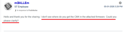

I am working on the NUCLEO-H755ZI-Q, which contains a dual-core STM32H755 (Cortex-M7 + Cortex-M4).
I configure the system clocks in CubeMX as follows:
  • SPI1/2/3 Clock MUX: 400 MHz
  • System Clock: Configured for high-speed operation
  • CM7 core frequency: Correctly matches the configured value (e.g., 200 MHz / 400 MHz depending on settings)
However, when I debug or read the CM4 core clock, I always see:
  • CM4 clock = 64 MHz
  • It does NOT increase even when I configure higher values in CubeMX.
Regards,
Prathiksha
12 REPLIES 12
Hello and thank you for sharing the details. I will share the folder structure!
project\PUMP_LOOP_EJECTOR_CPP\CM4\Core\Src or Inc
project\PUMP_LOOP_EJECTOR_CPP\CM7\Core\Src or Inc
You've previously shared that project but my question was:
So please clarify how you measured the clock frequencies in the firmware attached.
Keep in mind what you are claiming is impossible. The CM7 and CM4 clocks are not independent. It is not possible for the CM7 to be at 200/400 MHz while the CM4 is only at 64 MHz. So there has to be an error in how you're measuring, or how you're interpreting something.
