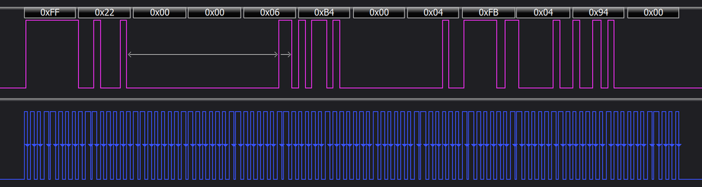

This is the result with prescaler set to 4 (12 Mbits/s). (Pink: MISO, Blue: SCK), the data is correct.

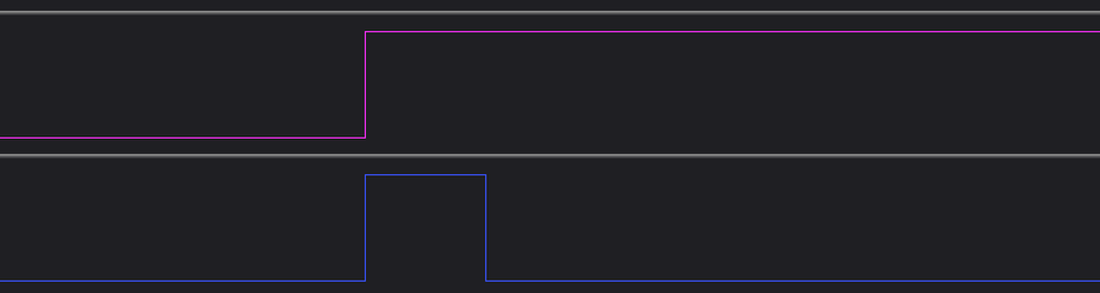

With the Prescaler set to 2 (24MBits/s) (Pink: MISO, Blue: SCK). The clock does not even try (the pulse is 3us)

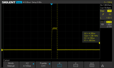

Thank you for your reponse, I had it connected with 10cm leads, however, since the clock is generated from the STM32C011 I have disconnected the SCK signal from the ADC, and now I am measuring the clock output from the STM32 directly from the pin headers of the devkit.
The sampling rate of the logic analyzer was set to 50MHz, but I have probed with the oscilloscope and got the same result: A 3-4us pulse but nothing else.
