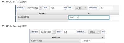

> Assuming that each core maintains its own set of debug registers, how do the M4 and M7 cores get different values when accessing the same physical address 0xE000EDF0?
When you debug the chip, you connect to an access point which is connected to a core. Here, either AP0 (M7) or AP3 (M4). When you ask for data at an address, it gets what is mapped at that address for that core. They share much of the same mapping (like SRAM) but not everything. Core registers are core-specific.
SCB->CPUID on M7 core (AP0):
SCB->CPUID on M4 core (AP3):

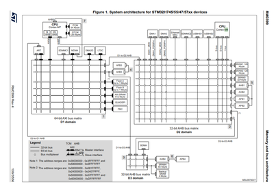

The two core have independent address spaces. They dual-port some common RAM and FLASH regions, and access to the peripherals.
The debug registers are unique to each Cortex-Mx core.
ARM has technical manuals. ST has the Programming Manuals (PM) which cover the debug registers to an extent.
Perhaps also check the Reference Manual (RM) to better understand the internal connectivity and the bus relationships with the cores, memory and peripherals .

I think you are right. Yesterday I checked the Arm®v7-M Architecture Reference Manual and found the CPUID base register. After accessing it through stm32cubeprogrammer, I got the same value as you.

I read about Memory and bus architecture, and found that addresses above 0xDFFFFFFF are reserved, so I can't tell from that. But the "Programming Manuals (PM)" you mentioned inspired me. I haven't paid attention to this material before, and I will look for it and learn from it. Thanks!
