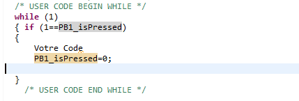

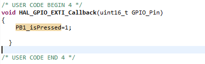

Hello again,
Thank you for your explanation!
So first of all, declare your variable (PB1_isPressed) which will be changed within the interrupt routine in Private variable section (View photo attached)
uint8_t PB1_isPressed=0;
0693W00000VOgqQQAT.pngNow in while(1) : implement your code in case PB1_isPressed is set.
Setting PB1_isPressed will be done in the Interrupt routine.
0693W00000VOgqkQAD.pngFinally, set your variable in the Interrupt routine
0693W00000VOgrEQAT.pngI hope that answers your question!
Thank you!
Sarra
