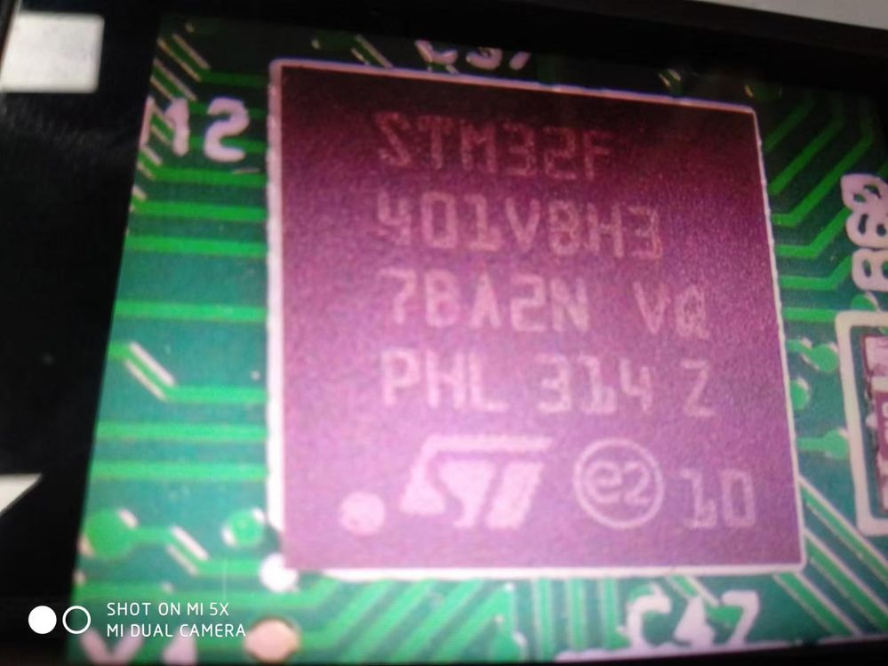

We purchased 403pcs MCUs (STM32F401VBH3) with date code 314 from Mouser website, as shown in the picture below, they have been assembled on the board,

However, we also have 98pcs MCUs (STM32F401VBH3) with date code 746, as shown in the picture below, they are also assembled on the same board, they can be successfully connected and can be successfully programmed.

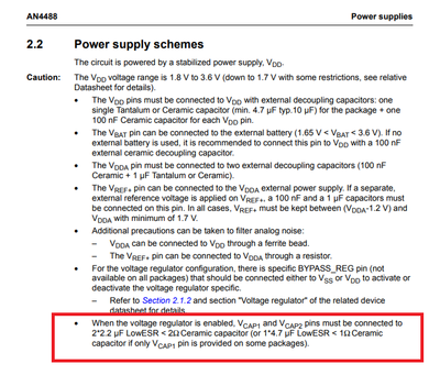

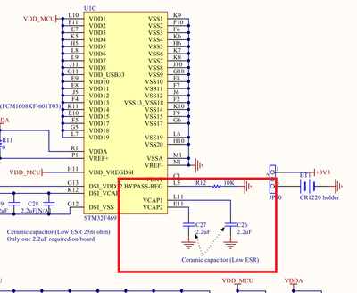

Is it a board you have designed? you need first to check your HW/Schematics:
Especially the VCAP capacitors:

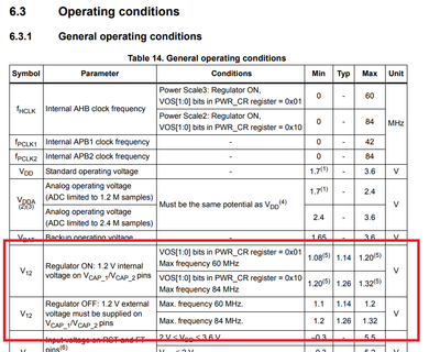

Check the V12 voltage level:
You should have V12 voltage in the range indicated in the table from the datasheet. And check if it's stable voltage and not presenting any glitch during the power-up and reset.
Check also the decoupling capacitors.
Please refer to the AN4488 "Getting started with STM32F4xxxx MCU hardware development"

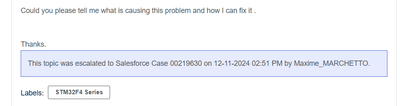

Your request has been escalated internally for further analysis.

I realized that your request was already escalated:
So please follow your request on OLS. case: 00219630
