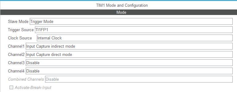

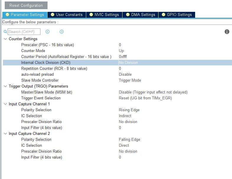

i want to measure time between high and low pulse from a ultrasonic sensor. The time is set to 1ms. It works until i reach the end of the time ARR.
To differentitat betwenn a distance like 1cm and 11cm (10cm end of the counter) i have to counte the timer reloads. In CubeMX is checked all the interrupts on but in eigther don't found the right interrupt or i don't activate all interrupts for Capture control timer (TIM1).
Did anyone know how to get the ARR Interrupt of the capture control?

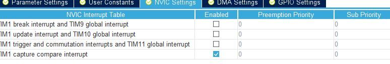

‎2019-08-21 12:21 PM
The "update" interrupt is what you need here (TIM_IT_UPDATE if you are using HAL, which I presume you are since you are using CubeMX). Whether this specific interrupt gets enabled by default by the HAL code depends on which TIM_***_Start_***() function you call. It sounds like you are calling HAL_TIM_IC_Start_IT(), correct? You can always manually enable that interrupt using the __HAL_TIM_ENABLE_IT(). Then make sure you have a HAL_TIM_PeriodElapsedCallback() function defined.

static void MX_TIM1_Init(void)
/* USER CODE BEGIN TIM1_Init 0 */
/* USER CODE END TIM1_Init 0 */
TIM_ClockConfigTypeDef sClockSourceConfig = {0};
TIM_SlaveConfigTypeDef sSlaveConfig = {0};
TIM_MasterConfigTypeDef sMasterConfig = {0};
TIM_IC_InitTypeDef sConfigIC = {0};
/* USER CODE BEGIN TIM1_Init 1 */
/* USER CODE END TIM1_Init 1 */
htim1.Instance = TIM1;
htim1.Init.Prescaler = 0;
htim1.Init.CounterMode = TIM_COUNTERMODE_UP;
htim1.Init.Period = 0xffff;
htim1.Init.ClockDivision = TIM_CLOCKDIVISION_DIV1;
htim1.Init.RepetitionCounter = 0;
htim1.Init.AutoReloadPreload = TIM_AUTORELOAD_PRELOAD_DISABLE;
if (HAL_TIM_Base_Init(&htim1) != HAL_OK)
Error_Handler();
sClockSourceConfig.ClockSource = TIM_CLOCKSOURCE_INTERNAL;
if (HAL_TIM_ConfigClockSource(&htim1, &sClockSourceConfig) != HAL_OK)
Error_Handler();
if (HAL_TIM_IC_Init(&htim1) != HAL_OK)
Error_Handler();
sSlaveConfig.SlaveMode = TIM_SLAVEMODE_TRIGGER;
sSlaveConfig.InputTrigger = TIM_TS_TI1FP1;
sSlaveConfig.TriggerPolarity = TIM_TRIGGERPOLARITY_BOTHEDGE;
sSlaveConfig.TriggerFilter = 0;
if (HAL_TIM_SlaveConfigSynchro(&htim1, &sSlaveConfig) != HAL_OK)
Error_Handler();
sMasterConfig.MasterOutputTrigger = TIM_TRGO_RESET;
sMasterConfig.MasterSlaveMode = TIM_MASTERSLAVEMODE_DISABLE;
if (HAL_TIMEx_MasterConfigSynchronization(&htim1, &sMasterConfig) != HAL_OK)
Error_Handler();
sConfigIC.ICPolarity = TIM_INPUTCHANNELPOLARITY_RISING;
sConfigIC.ICSelection = TIM_ICSELECTION_INDIRECTTI;
sConfigIC.ICPrescaler = TIM_ICPSC_DIV1;
sConfigIC.ICFilter = 0;
if (HAL_TIM_IC_ConfigChannel(&htim1, &sConfigIC, TIM_CHANNEL_1) != HAL_OK)
Error_Handler();
sConfigIC.ICPolarity = TIM_INPUTCHANNELPOLARITY_FALLING;
sConfigIC.ICSelection = TIM_ICSELECTION_DIRECTTI;
if (HAL_TIM_IC_ConfigChannel(&htim1, &sConfigIC, TIM_CHANNEL_2) != HAL_OK)
Error_Handler();
/* USER CODE BEGIN TIM1_Init 2 */
//__HAL_TIM_GET_FLAG(&htim1, TIM_FLAG_UPDATE);
/* USER CODE END TIM1_Init 2 */
‎2019-08-23 2:57 AM

‎2019-08-23 6:45 AM
int main()
HAL_TIM_IC_Start_IT(&htim1, TIM_CHANNEL_1);
HAL_TIM_IC_Start_IT(&htim1, TIM_CHANNEL_2);
No, that will not work (as you discovered). That code is starting the timer in input capture mode, enabling channel 1 interrupt only. The 2nd line attempts to RE-START the timer in input capture mode enabling channel 2 interrupt only. The 2nd call will fail, and if you had checked the return status it would have been HAL_BUSY, not HAL_OK. Lesson #1 - always check the return code from HAL "start" functions!!!!!!!!!!!
You should be able to call HAL_TIM_IC_Start_IT() one time, then use the __HAL_TIM_ENABLE_IT() macro just to enable the channel 2 interrupt. Like this:
int main()
HAL_StatusTypeDef halsts;
halsts = HAL_TIM_IC_Start_IT(&htim1, TIM_CHANNEL_1);
if ( halsts != HAL_OK ) {
// Report the error here, somehow
// printf( "Timer init failed, sts %d\n", halsts );
__HAL_TIM_ENABLE_IT(&htim1, TIM_CHANNEL_2);
‎2021-03-03 2:59 PM
__HAL_TIM_ENABLE_IT(&htim1, TIM_IT_UPDATE);
