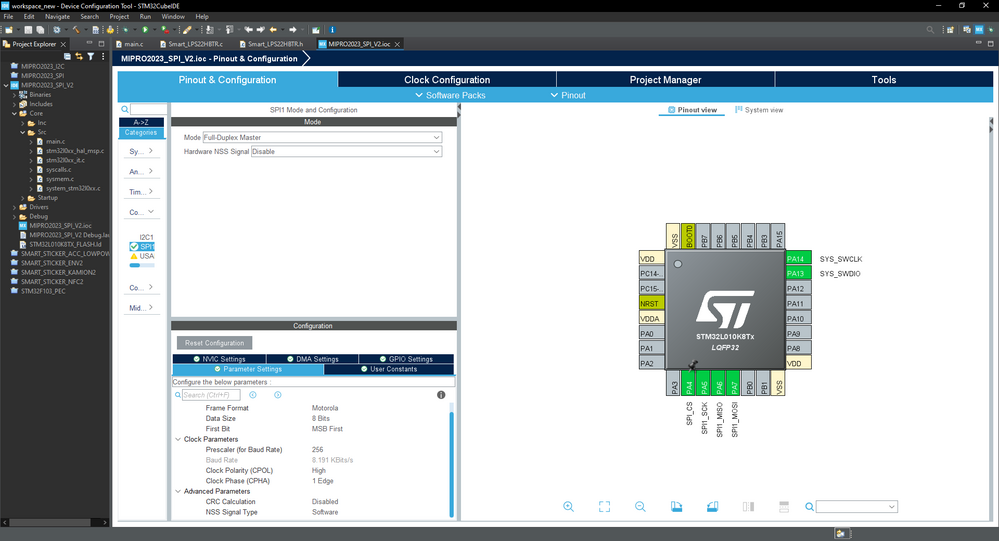

Greetings good people of ST community
I have a problem which I didn't manage to solve by myself, so I am hoping to get some help if possible
I have an LPS22HB sensor (https://eu.mouser.com/datasheet/2/389/lps22hb-1849683.pdf), and I want to connect it to STM32L010K8T6 MCU using SPI. The problem is, I get some temperature register readings with STM studio but they are invalid (0, 128, 255).
In settings, the MCU CS pin is a pull-up, while pins SCK, MISO, MOSI are no pull-up and no pull-down. All of them are in push-pull mode.
These are my SPI setting in the code:
hspi1.Instance = SPI1;
  hspi1.Init.Mode = SPI_MODE_MASTER;
  hspi1.Init.Direction = SPI_DIRECTION_2LINES;
  hspi1.Init.DataSize = SPI_DATASIZE_8BIT;
  hspi1.Init.CLKPolarity = SPI_POLARITY_HIGH;
  hspi1.Init.CLKPhase = SPI_PHASE_1EDGE;
  hspi1.Init.NSS = SPI_NSS_SOFT;
  hspi1.Init.BaudRatePrescaler = SPI_BAUDRATEPRESCALER_256;
  hspi1.Init.FirstBit = SPI_FIRSTBIT_MSB;
  hspi1.Init.TIMode = SPI_TIMODE_DISABLE;
  hspi1.Init.CRCCalculation = SPI_CRCCALCULATION_DISABLE;
  hspi1.Init.CRCPolynomial = 7;
My hardware pinout is as following:
INT_DRDY (LPS) - not connected/used
CS (LPS) - SPI_CS (MCU)
SDO/SA0 (LPS) - SPI_MISO (MCU)
SDA/SDI/SDO (LPS) - SPI_MOSI (MCU)
SCL/SPC (LPC) - SPI_SCK (MCU)

I found the solutions to my problems. I had two problems:
1) As KnarfB pointed out, it should be like this => hspi1.Init.CLKPhase = SPI_PHASE_2EDGE;
2) When reading the register, I didn't send the R/W bit correctly (1 == read), so I failed to get good data
The code below is what works great for me. I appreciate your help KnarfB and S.Ma.

KnarfB
If I look at the data sheet, shoudn't it be hspi1.Init.CLKPhase = SPI_PHASE_2EDGE;
hth
