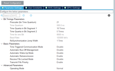

Hi SofLit .. I checked again the cube configuration ..
and numbers are ok for 125 kbit/s
  * @brief CAN1 Initialization Function
  * @PAram None
  * @retval None
static void MX_CAN1_Init(void)
  /* USER CODE BEGIN CAN1_Init 0 */
  /* USER CODE END CAN1_Init 0 */
  /* USER CODE BEGIN CAN1_Init 1 */
  /* USER CODE END CAN1_Init 1 */
  hcan1.Instance = CAN1;
  hcan1.Init.Prescaler = 21;
  hcan1.Init.Mode = CAN_MODE_NORMAL;
  hcan1.Init.SyncJumpWidth = CAN_SJW_1TQ;
  hcan1.Init.TimeSeg1 = CAN_BS1_10TQ;
  hcan1.Init.TimeSeg2 = CAN_BS2_5TQ;
  hcan1.Init.TimeTriggeredMode = DISABLE;
  hcan1.Init.AutoBusOff = DISABLE;
  hcan1.Init.AutoWakeUp = DISABLE;
  hcan1.Init.AutoRetransmission = ENABLE;
  hcan1.Init.ReceiveFifoLocked = DISABLE;
  hcan1.Init.TransmitFifoPriority = ENABLE;
  if (HAL_CAN_Init(&hcan1) != HAL_OK)
    Error_Handler();
ma still not enter inside here  transmitting at 125 kbitS
