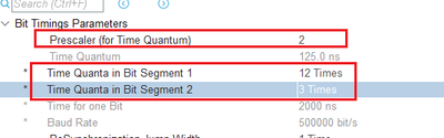

At first check at your ioc file, I don't recommend these values for CAN bit timing:
hcan1.Init.Prescaler = 16;
hcan1.Init.TimeSeg1 = CAN_BS1_1TQ;
hcan1.Init.TimeSeg2 = CAN_BS2_2TQ;
BS1_1TQ and BS2_2TQ are very low. You need to increase them as much as possible by decreasing the prescaler as much as possible.
I recommend these values for 500kb/s:

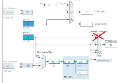

Also, we don't recommend HSI as clock source when using CAN in Normal mode. You need to use HSE with an external crystal otherwise you may face communication issues.

Segment 1 should be larger than Segment 2. Use this online calculator http://www.bittiming.can-wiki.info/

With the bit timing provided by @mƎALLEm, the TX no longer failed. With the code from @Karl Yamashita , the reception also worked.
