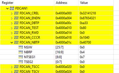

Therefore the corresponding registers are set as follows:
With:

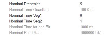

this excerpt in the reference manual, the calculation is:
tfdcan_tq_ck = 0,02 µs  <- (1/50MHz)
tq = 0,1µs          <-             (0,02 *  5)
The bit time ist 1µs   <-  (0,1 *( 7+1+0+1+1))
-> baudrate is 1 Mhz    -> 1/1µs
But in the outgoing frames, I measure a bit time of approx. 3µs.
Enlarged:
How can that be? What did I do wrong or overlook?

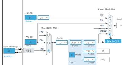

Just forget that you are using a nucleo-h755ZI-Q while in the Clock config you set the crystal to 25MHz in a crystal mode! But there is no external crystal in that board connected to OSC_IN/OSC_OUT.
This is the schematic:
What I suggest is to use the bypass mode but for that you need some steps:
1- Modify the STLINK MCO output to generate 5MHz instead of 8MH generated from HSI. Ensure SB72 is soldered. Please refer to this article to do that: How to use STLINK-V3 MCO output on Nucleo boards as a precise clock source for STM32
2- In your ioc file you need to update the RCC config: HSE in Bypass mode with HSE value = 5MHz
+ use the same bit timing config I provided in my previous post.

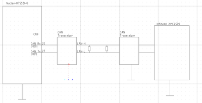

Hello m3ALLEm,
Here is a sketch to illustrate this:
Best regards,
HiST

There is another node that is not responding. The measurement should show at least one bit with the correct time.
I also have a logic analyzer that cannot interpret the signal from the FDCAN1.
Best regards,
HiST

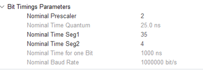

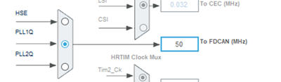

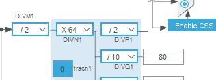

3- Better to increase the FDCAN clock and increase TSeg1/Tseg2 values with a sampling point positioned at ~87.5%. Therefore, I recommend the following config:
FDCAN clock source = PLL1Q = 80MHz:
and CAN bit time (sample point set at 87.5%):
Hello m3ALLEm,
yes, thank you, this was the solution.
And also responsible for some other problems I had.
Now I also measure the correct bit time.
Best regards,
