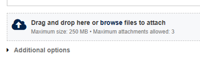

@Ash1 wrote:
Hi
How Can I attach project in reply
with drag and drop feature:
