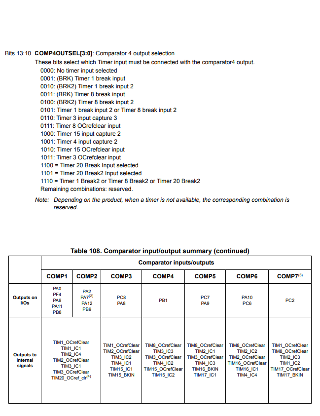

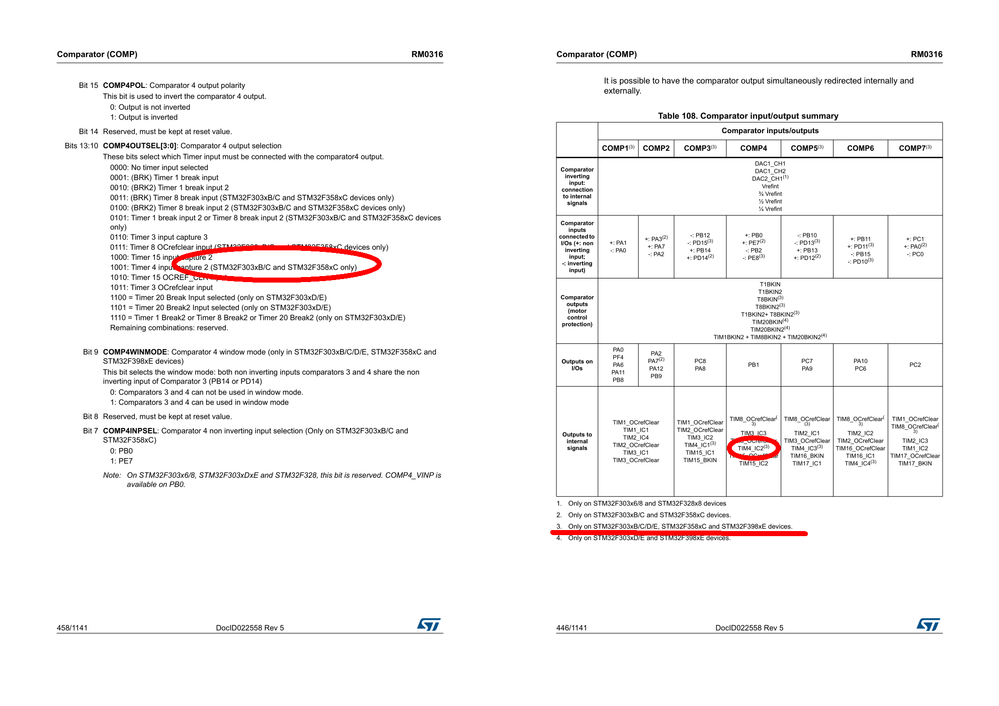

Maybe TIM2_CH4 is unavailable in the 'F303xE. The 'F3 OPAMP and COMP chapters are full of errors.
@Imen DAHMEN​ , can this please be clarified?
Thanks,
PS. AN4651 is not helpful, it appears to be a verbatim copy of the interconnections chapter which is not helpful either, as the exclusions are not detailed in the COMP-to-TIM table at all.
Regarding the RM0316, the contradiction notes have been removed on the latest RM Rev8.
Best Regards,
Imen
Thanks
Imen
When I saw this I got my hopes up .... but I'm already using RM0316 Rev8. Still can't seem to get COMP4 to run TIM4_IC2. Yet can get external GPIO to run TIM4_IC1 or TIM4_IC2. Also, I do see COMP4 on output PB1.
Nice to know my RM0316 Rev 8 is latest copy though, thanks !
waclawek.jan
Huh, I failed to keep up with the RM update on this particular machine... :blushing: ... sorry for the noise, and thanks for the prompt clarification, Imen!

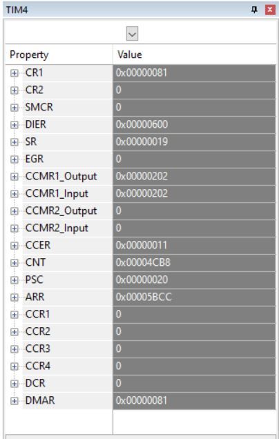

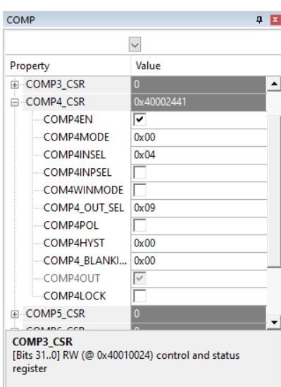

Read out and check/post the content of relevant COMP and TIM registers.
@Imen DAHMEN​
Hi ,
I'm attaching snapshots of COMP4 Reg and TIM4 Reg,0693W000001tEfMQAU.jpg 0693W000001tEflQAE.jpg
waclawek.jan
This all looks reasonable, the channels' crossing is a bit weird but that's probably the experiment you've described in your initial post.
Also, you have DMA enabled on both CC1 and CC2, why's that? Is there any difference if you don't enable that DMA?
