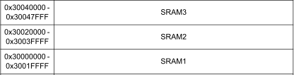

(This is regarding STM32H75x)
SRAM1, SRAM2, and SRAM3 are separate in the memory map, but they are continuous - there are no gaps between them:
Can they be treated as continuous with respect to the linker, for example:
RAM_D2    (xrw)    : ORIGIN = 0x30000000,   LENGTH = 288K
And then place some arbitrary data in that region?
Like, can we place an array that is 288k in that region and use it as a heap, or will bad things happen at the region where SRAM1 ends / SRAM2 starts, etc?

From the processors perspective they look/appear contiguous.
From and DMA/BUS perspective they might be treated differently, you'd have to review in the context of the bus matrix diagrams
Clocks should also be enabled.
To use as heap, they're contiguous and the linker doesn't care what they, read https://sourceware.org/binutils/docs/ld/MEMORY.html#MEMORY.
  SRAM123 (rw) : ORIGIN = 0x30000000, LENGTH = 0x48000
Otherwise find your part's RM and other resources, e.g. AN4891, at https://www.st.com/content/st_com/en/search.html.
Pavel A.
If this is relevant for your application, test whether multi-byte writes over the boundary of the RAMs don't cause trouble.
For example: *(uint32_t *)(0x3003FFFF) = 0x12345678; *(uint32_t *)(0x3001FFFE) = 0x12345678;
-- pa

One interesting thing: I did not realize that clocks had to be enabled for these SRAM blocks, and I was somehow using them just fine without those clocks enabled.
I am not sure how... but I have added the clock init in.
