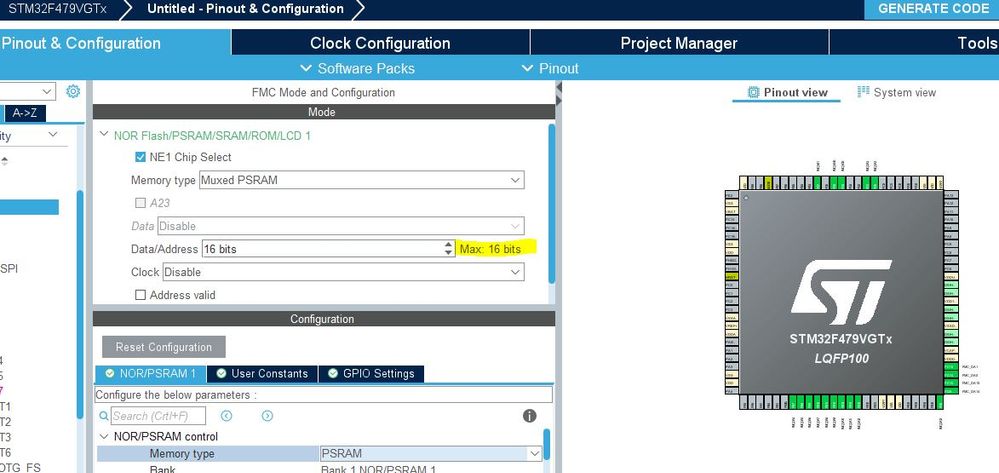

You can check the PSRAM configuration and address max with STM32CubeMX.
For example, with LQFP100 package : Max 16 bits for Muxed PSRAM.

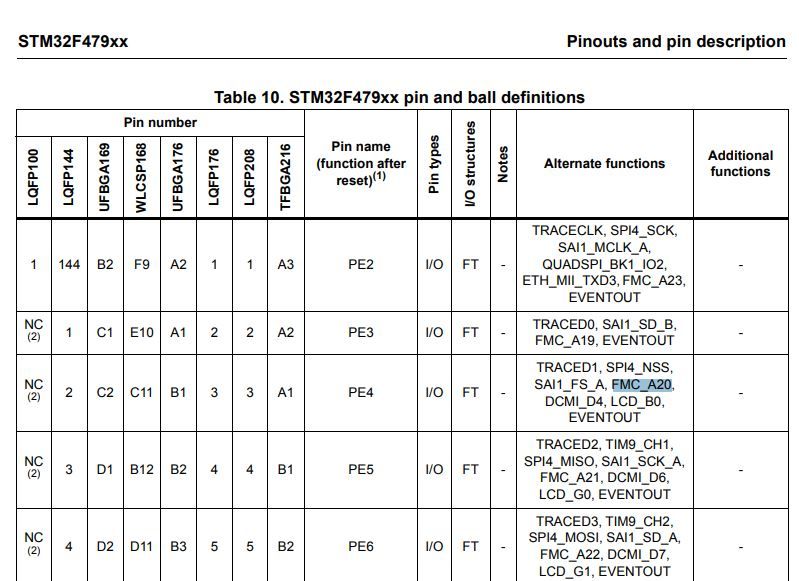

0693W000008ynGAQAY.jpgYou can refer to the Table 10. STM32F479xx pin and ball definitions in the STM32F479xx datasheet to check the PSRAM address pins.
0693W000008ymw5QAA.jpgImen

Sorry - I have to use the STM32F479 in LQFP100 package but somehow I can't find any PSRAM with up 8Mbit+ which can be used.. or I missunderstand how it should work.
Hopefully you can help me to get in the rigth direction.
EDIT: Am I right that if I use this RAM I'm only able to use 128 kbyte by leaving A16-A18 unconnected / gnd?
So it looks like its not possible to drive 400 x 600 display with that package?
