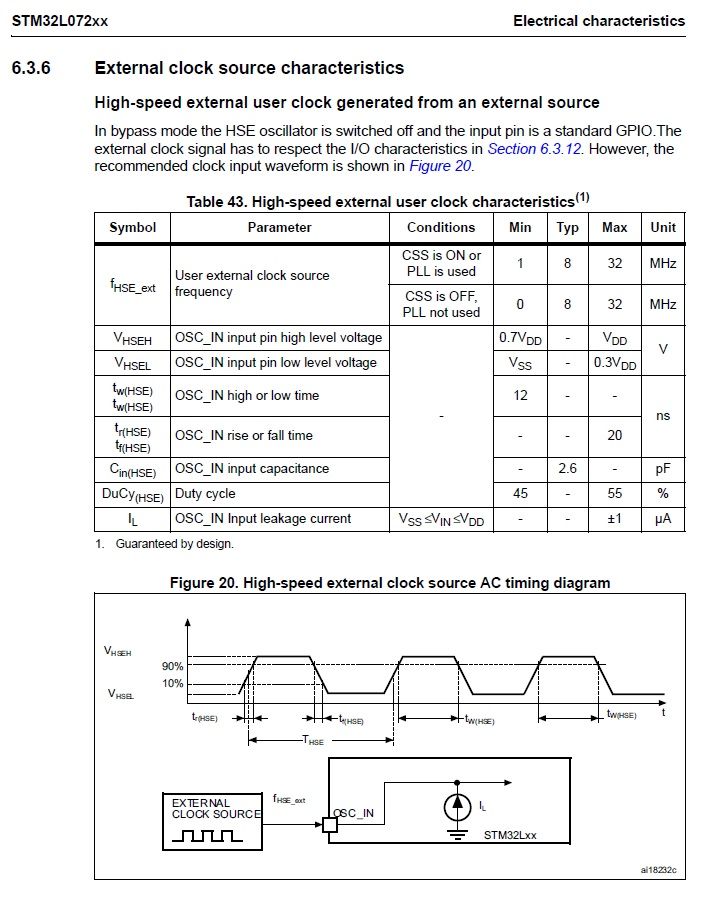

0693W000006GCVlQAO.jpgI haven't tested the H7 implementation, but I'd be cautious..
A secondary effect would be some potentially very undesirable behaviour out of the system boot loader..

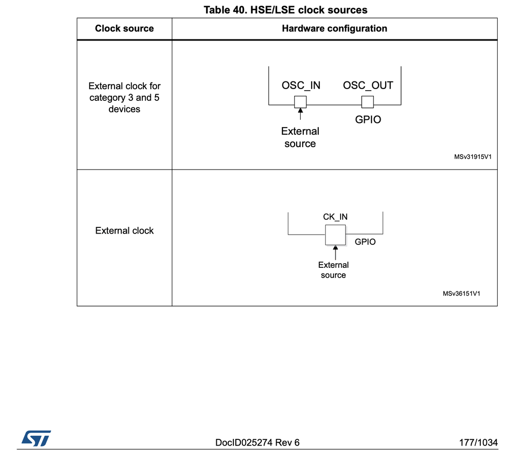

@Community member​ I was convinced that I had read it somewhere, but cannot retrieve it. Maybe it was the table 40 in the reference manual that was misleading me. But in the text it is written that the OSC_OUT must be left "hi-Z". Thanks for pointing this out.0693W000006GEENQA4.pngFrom the moment I used the MSI oscillator instead of the HSE in bypass mode, the output PH1 is useable. As clock resolution and stability is not important for this project, I can continue this way.
