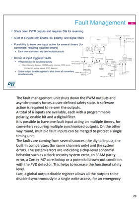

Hi, I have an application with 4 legs PFC and 2 legs inverter controlled by the STM32G484VET3.
Can I use one input to disable both when a fault happens independently from the software?
Thank you.

A reference provided by STM32 Sidekick tool
