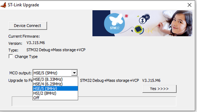

@sethkaz wrote:
I'm going based off what the person said.
I've tried the MCO output, and it does not solve this issue.

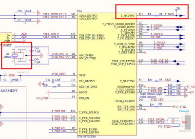

It depends on what stlink is outputting. STLINK itself could generate MCO output from its internal clock source or from its external crystal. So you need to use STSW-LINK007 tool to set the MCO output source. You need to set an integer value for HSE to find suitable velues when you set prescalers later on.
According to NUCLEO-U545RE-Q schematics STLINK module is clocked by a 24MHz.
Unfortunately I don't have that board to test but as stated before you need to configure STLINK MCO to output a clock generated from its HSE.

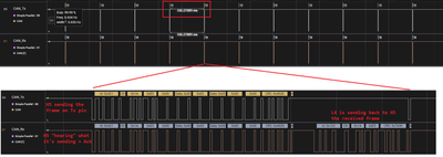

I created two projects with NUCLEO-U545 and NUCLEO-L432. I didn't reproduce that "repeating" frame behavior on oscilloscope.
The example consist of:
U545 is sending a frame at 150ms period, L432 receiving it and sending it back to U545 MCU.
Each time a frame is received the Green LED is toggling for each device.
Could you please use my projects to test from your side and get back to me with the results?
EDIT: I used MCP2562 as transceivers.

I'm adding screenshots from my logic analyzer:
If you can see the interval between frames are 150ms as I already programmed in the code and the frames on CAN_Tx and CAN_Rx are correct. So again no repeating behavior.
