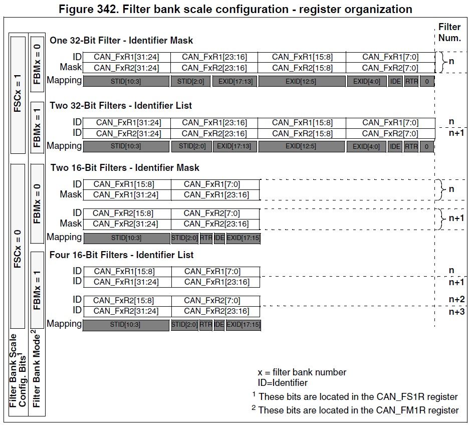

Hi every one, especially Mr.Clive, today i have problem with CAN FILTERS i want to allow all IDS from 100 to 1FF in other words block all messages after 0x0200
here is my code, Please help me, Thanks in advance
void CAN_FilterConfiguration(void) {
CAN_FilterInitTypeDef CAN_FilterInitStructure;
/* CAN filter configuration */
// CAN_FilterInitStructure.CAN_FilterNumber = 0; // CAN 1
CAN_FilterInitStructure.CAN_FilterNumber = 14; // CAN 2
CAN_FilterInitStructure.CAN_FilterFIFOAssignment = CAN_FIFO0; // FIFO = 0
CAN_FilterInitStructure.CAN_FilterMode = CAN_FilterMode_IdMask; // Filter mode = identifier mask based filtering
CAN_FilterInitStructure.CAN_FilterScale = CAN_FilterScale_16bit;
CAN_FilterInitStructure.CAN_FilterIdHigh = 0x0100 << 5;
CAN_FilterInitStructure.CAN_FilterIdLow = 0;
CAN_FilterInitStructure.CAN_FilterMaskIdHigh = 0x01ff << 5;
CAN_FilterInitStructure.CAN_FilterMaskIdLow = 0;
CAN_FilterInitStructure.CAN_FilterActivation = ENABLE;
//Interrrupts
CAN_ITConfig(CAN2,CAN_IT_FMP0,ENABLE);
CAN_FilterInit(&CAN_FilterInitStructure);
#!stm32f4-disco #can-filter

You filter the stuff you WANT to receive, it ignores the rest

Hi Clive,
i am facing a problem, i want to accept all messages to CAN except with the ID 0x17F00010 that uses a EXT ID. all my other messages are StdID. i am able to create filter that wastes the messages with IDs 0x10 but that also filters messages with ID like 0x710. need your help. Thanks in advance.
The filter only really allows for acceptance, you would need to have multiple filters to cherry pick things to reject by accepting everything around the specific thing you don't want. A narrow-band notch filter may be hard to achieve.
The mask should permit you to filter on STD/EXT ID. Bit 2 of the filter will be 1 for Extended Identifier Messages
What is the 29-bit ID you want to exclude? What other messages are you expecting? Create a list

Uvess.1
hi @Community member​ ,
I tried to understand with this examples but it's not obvious for me...
For exemple we want to accept address between 0x008 and 0x04F
So Filter_id_high = 0x008<<5
but i don't know how to calculate the mask....
EDIT1: so we've (MASK & ID) = 0x008
CAN_FilterInitStructure.CAN_FilterScale = CAN_FilterScale_32bit;
CAN_FilterInitStructure.CAN_FilterIdHigh = 0x008 << 5; //11-bit ID in top bits
CAN_FilterInitStructure.CAN_FilterMaskIdHigh = 0x??? << 5;
Thx in advance,
