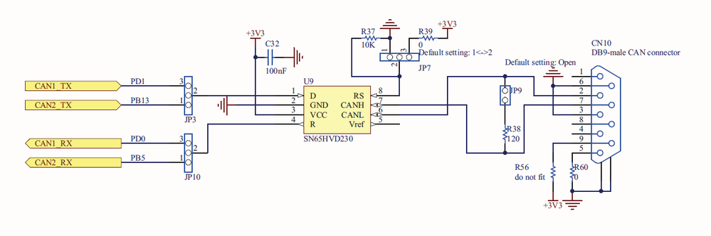

To use CAN you have to setup the HW:
  • Add a transceiver (SN65HVD230 as an example).
  • Add a termination resistor of 120ohm
From STM3240G-EVAL schematic:
_legacyfs_online_stmicro_images_0693W00000biIawQAE.png For the CAN software you can refer to the example provided by STM32CubeF4 package under the path Projects\STM324xG_EVAL\Examples\CAN\CAN_Networking.

mƎALLEm
I've already provided the details: HW setup and a project example using CAN networking.
Use STM3240G-EVAL as reference.

mƎALLEm
STM3240G-EVAL board features a STM32F407IGH6 which is the same die. You can use it as a reference. Refer to the schematics in the Appendix A section "Schematics".
