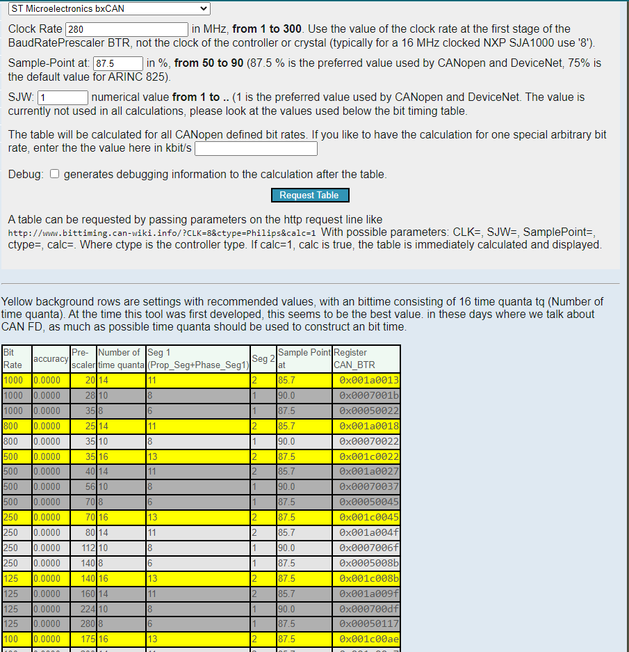

Based on what I've read online, I used this website to do my bit timing calculation:
http://www.bittiming.can-wiki.info/
I want to run a 500 kBit/s baud rate for my example. I would like to verify my steps:

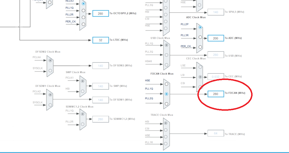

- For this, I went to the .ioc file and it says the FDCAN clock is 280 MHz (Proof: Picture FDCAN_Ex)
Step 2: Use bit timing calculation website:
Step 3: Define hfdcan1.Init parameters in code:
Based on this, have I configured this properly for 500 kBit/s? Do I have the nominal sync jump width used correctly? (I don't see a mention of sync jump width on the website).

Sorry, the image for the .ioc clock frequency did not send.
‎2022-10-19 12:48 PM
STM32Cube_FW_H7_V1.10.0\Projects\STM32H7B3I-EVAL\Examples\FDCAN\FDCAN_Loopback\Src\main.c
They set up a PLL to source the FDCAN clock
Yours at 280 MHz would need a prescaler or 14 to get to 20 MHz

I did see this configuration, but I was thrown off because the PLL in my .ioc file is 280 MHz. So would that not change the values above? Is fdcan_ker_ck different than the PLL1Q (FDCAN) in my .ioc file?

To further clarify, the bit timing calculator worked as intended.
