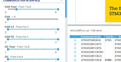

Please suggest me STM32 product which can be used to analyze CAN bus. also send and receive data thru CAN bus. Is there any STM32 available with CAN build in peripheral. I currently have STM32F411RE.
STM32CubeMX can be used to filter chips by the available peripherals.
There are 1164 chips with 1 or more CAN buses. For example, most chips in the H7 and H5 series. The STM32H723ZG could be used.
You will need to use a CAN transceiver chip.
