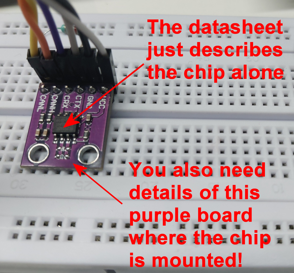

I am using two microcontrollers i.e., for transmitting data I have to use STM32F407VET6 and for receiving I have to use STM32F407VGT6 also I have to connect MCP2551 CAN Transceiver. I am transmitting data from one board and receiving data from another board through CAN Bus Protocol Communication
However, the data is not transmitted and received. I have properly checked the hardware connections and terminated the bus at both ends with 120-ohm resistors.

It needs to connect Rs to Ground for both the transreceiver??
Indeed for each transceiver Rs pin must be (at least) tied to the GND.
You need to share the module's schematics.
I have attached the Transceiver Datasheet.
The datasheet only describes the chip itself.
We also need details of those boards ("modules") on which you have the the Transceivers mounted!
The schematic(s) for those boards will tell you whether they ground the  Rs pin or not.
I've already the transceiver datasheet need the schematics of the module.
You didn't give feedback about my previous questions.
Need more effort from your side to help you efficiently.

The RS pin is already grounded through a 4.7k resistor.
Show a diagram on how you've connected each of the pins on the CAN module to your STM32F407. Is this a custom board? Do the two STM32F407 have a ground reference between them or are they isolated from each other besides just the 2 CAN wires?
According to the schematics? Do you have it?
