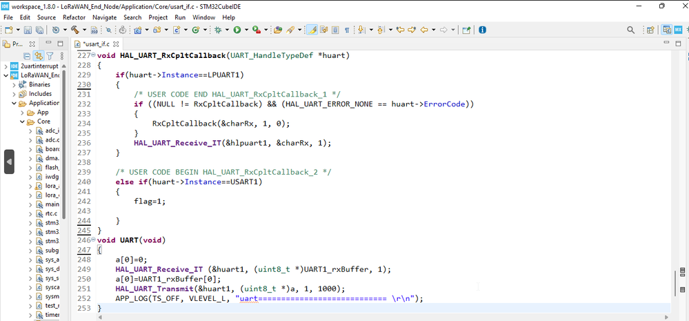

I am using 2 Uart with interrupt function. I have enabled two interrupts at the same time. But I can access only one Uart at a time. Another Uart interrupt is no response.

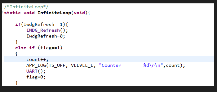

--> I put a flag in RX complete call back function and I check the flag in while loop and also I set increment count in while loop.

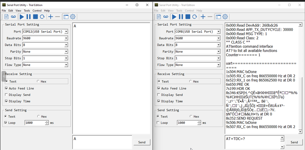

Result:
After reset the device that time only UART1 interrupt is triggered. Below I have attached the screenshot

set flag in RX complete call back function:
Serial Monitor:
