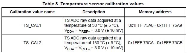

According to the data sheet, the calibrated values for specific chip (at 30°C and 130°C) are at the following addresses:
#define TEMP30_CAL_ADDR (*((uint16_t*)0x1FFF75A8))
#define TEMP130_CAL_ADDR (*((uint16_t*)0x1FFF75CA))
Therefore the calculation should be :
fCalTemperature_DegreeCelsius = (((130.0f - 30.0f) / (TEMP130_CAL_ADDR - TEMP30_CAL_ADDR)) * (ADC_TempReading - TEMP30_CAL_ADDR)) + 30.0f;

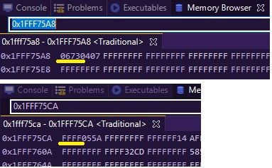

The problem is that in memory the values don't seem to be correct:
I'd appreciate any help.

The TS_CAL1 and TS_CAL2 values are *halfwords*, so if the above display is the usual little-endian, TS_CAL1 is 0x0407 and TS_CAL2 is 0x055A.

These will be evaluated to 0x407 and 0x55A, so they're values not addresses.

0x407 = 1031 (calibrated at 30°C)
0x55A = 1370 (calibrated at 130°C)
