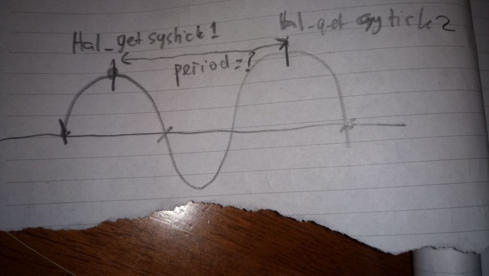

Dear Members,
How can I count a pulse from a sensor with timer ?
How can I calculate the period of this pulse ?

‎2019-06-09 8:32 AM
Get a TIMer example from a STM32 Cube Nucleo board project.
It's called Timer Input Capture for the generic way of doing it.
Connect the pulse source to the timer channel 1 for example.
Setup input capture on falling edge
The timer for example runs at 1MHz, count up to 65536 and overflows back to 0 forever.
If you use interrupt on falling edge of the input capture, save the value and substract it from the previous occuring interrupt.
Capture n=5 : read 0x0500
Capture n=6 : read 0x0680
Capture n=7 : read 0x800
Period is 0x680-0x500 = 0x180
Or 0x800 - 0x680 = 0x180
Works even with overflow... nothing to worry.
0x180 = 384 = 384 usec (1MHz timer) = 2.6 kHz
Lowest HW measureable frequency it the timer period.
Measuring the hgih and low time is possible, just select rise/fall edge for high level.
‎2019-06-09 8:50 AM
Configure TIM in External Count mode?
Configure the TIM in free-count mode, and time-stamp events, delta the CCRx samples.
‎2019-06-09 7:33 PM
I'm thinking with Hal_GetSystick ?

How can I take the maximum output as my starting period (1) and end period (2) ?
I have LowPassFilterIR max and LowPassFilterRed max values ...
Thanks
‎2019-06-09 7:53 PM
I have
max = 0;
if ( lowPassFilterIR>max)
max = lowPassFilterIR;
printf("LowPassFilterIR max %f \r\n",lowPassFilterIR);
How can I take timestamp of that value ?
‎2019-06-09 8:21 PM
Keep track of when you take each sample, or understand the sample rate.​
