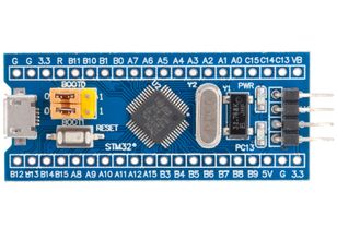

stm32F103 timer3 pwm crashes with No source available for "uwTickPrio() at 0x20000004"
PGood.1
An application created directly for the configurator where TIM3_CH! is set to PB4 where the internal clock is either ticked or not ticked it crashes at if (HAL_TIM_PWM_Init(&htim3) != HAL_OK) with No source available for "uwTickPrio() at 0x20000004"

What board is this? Is BOOT0 pulled low?

Hello @PGood.1 ,
Make sure that ST-LINK V programmer as your programmer/debugger.
Maybe stack corruption occurred in your application.
Thanks
Imen
mƎALLEm
1- Please use </> button to paste your code. See this post. I've already edited your post.
2- Are you using this board?:
