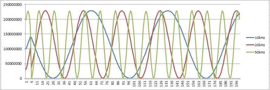

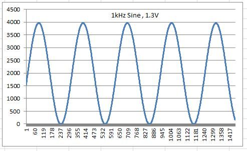

I am using the ADC on NUCLEO- STM32F401RE board. I have programmed the ADC using interrupts store about 10,000 values in an array and read them using a .ini file. The code does not work beyond 10kHz of input signal. ADC is of 12 bit resolution with 3 sampling cycles ; ADC clock frequency is 21MHz. Below is my code and plot of values for input frequency range of 1- 200Khz sine wave. The input voltage is 1.3V. What am I missing?

Edit : PFA code and plot of values for input frequency range of 1- 200Khz sine wave of 1.3 Vpp.  ADC is of 12 bit resolution with 3 sampling cycles ; ADC clock frequency is 21Khz.

I usually don't mess with Cube code.
But I'm pretty sure the interrupt runtime is the limiting element here, which means interrupt handler and callback, which is called in that context.
The handler code itself is missing.
Try to measure the runtime, either with help of the toolchain, or with GPIO toggling and a scope.
BTW, a sampling time of 3 cycles is quite short, and a bit of a chellange for the attached hardware.
For 10..20kHz, you can go much higher.
And, I would consider using DMA instead of interrupts. You would get an TC interrupt after (supposedly) your 10000 values.

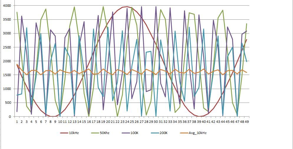

archana95in
0690X000008iOxLQAU.jpg0690X000008iOxGQAU.jpgThank you for your inputs.I used DMA continuous conversion and stored the values for 12 bits ADC with ADC clock freq= 21 Mhz. Here is a snippet of my code

There is an improvement and works until 40kHz, but is distorted beyond that. Is this due to HAL overhead? How do I get the ADC to work for input frequencies between 100kHz-250kHz.
Also increasing the sampling cycles did not bring about any useful progress.

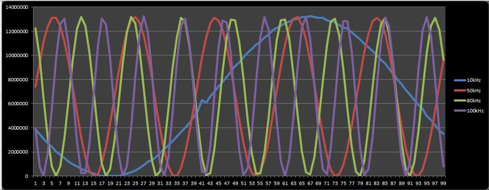

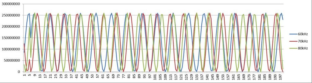

archana95in
0690X000008iQ7lQAE.jpgI modified my code as per your suggestion and also reduced the resolution to 8 bits. These were the best values I could get. PFA my code and plot. What other changes can I make so I will be able to comfortably sample input frequencies between 200-250kHz? Or is that not possible at all when I am using HAL?

Why the looping in this fashion? Get the DMA to complete the 10000 samples and save the content.​
If you need a continuous sampling use a double size buffer and move half the content at HT and TC DMA interrupts.​
