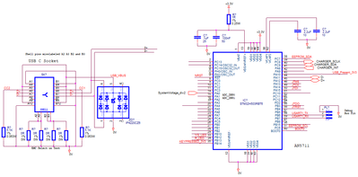

We wish to bootload a STM32H503RB using USB. This works on the NUCLEO-H503RB, but after resetting the processor on our PCB with BOOT0 high windows reports "Device Descriptor Request failed".
AN2606 states that CRS is enabled for the DFU to allow USB to be clocked by HSI48 48 MHz, but is there anything CRS needs to work?

Maybe show schematics , seems some hw fail on your pcb

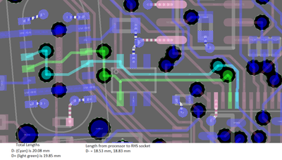

USB socket and processor are within 30 mm, D+ and D- both have 2 or 3 vias. We have tried remove the IP4220CZ6 and behaviour did not change.

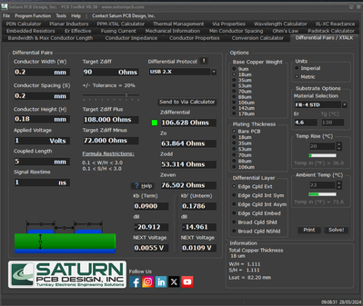

D+ D- is USB differential pair must meet wired impedance and length minimum difference on pcb...

In case it matters PC14/OSC32_IN drives a HC logic device. Shorted pin to 0V (so it wouldn't try and lock to noise) and still got the USB error.

Impedance could be improved, but I believe this should be sufficient for FS (12 MHz) performance. Total distance is less than 25 mm.
