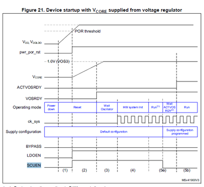

We don't understand the bit SCUEN of STM32H7.
The description is not very clear:
Could you explain what SCUEN means and if the software is supposed to write or read this bit and why ?

It's in the technical reference manual, nothing exotic...
Chapter 6 "PWR"
LCE
Principal II
No SCUEN bit in RM0468 for STM32H723/733, STM32H725/735 and STM32H730
We are looking at RM0433 review 8
§6.4.1
The 21st figure describes the hardware start-up procedure but its unclear wether software or hardware is responsible of its use

Okay, RM0433.
You should always say which STM32 / H7 exactly you are using, even in the "basic" registers there seem to be some differences between the H7 types.
I would check how the HAL libraries are using this bit, if they are using it all.
